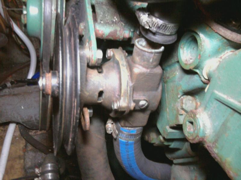

Morning Gents (and ladies). I removed my raw water pumps back in the fall to do impellers. Now I'm putting them back together and can't remember which way they go??:confused: This pic is my Starboard motor,(right hand rotation) it made sense to me to have the intake and output ports facing towards the left, as you know the ports are not in the middle, this way with the motor turning clockwise it would suck up raw water from the bottom.I did the exact opposite to the Port motor, turing the housing so the ports are facing towards the right (if that makes any sense?) Please tell me if this correct I don't want to start it with it being in wrong.

So Rick, from what you're telling me, the pump shown needs to be flipped? again..this is my Starboard engine.
BTW, the cam screw is what tells me the orientation of this pump, and that it needs to rotate CW (viewed from front) in order to work with the inlet below, and with the outlet above.
Flit this pump 180* and it will be correct for CCW rotation (viewed from front).
If your Stbd engine is most likely a counter-rotating engine... I.E. RH Reverse Rotation like this........... correct?
If so, then your Sherwood pump will be in this orientation when viewed from the front.
(inlet/outlet ports to the left..... impeller off to the right side turning in a couner-clockwise direction)
