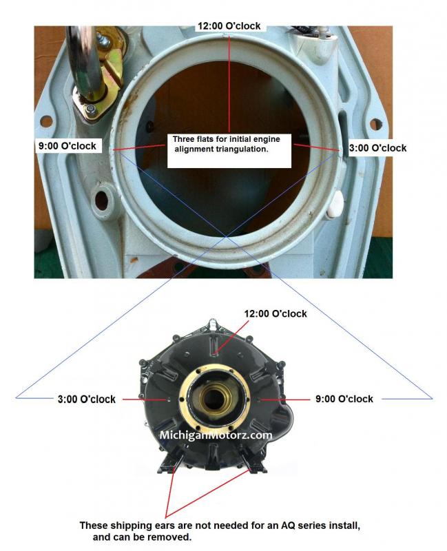

The standard 280 is lift-out only. The 280 PT (as shown in the schematic) has power trim. Be careful when using the lift-out with the std 280.
slows down when in the down position the engine does NOT have to be running - I am relatively sure that this is not an issue with a leaky freeze plug behind the flywheel.

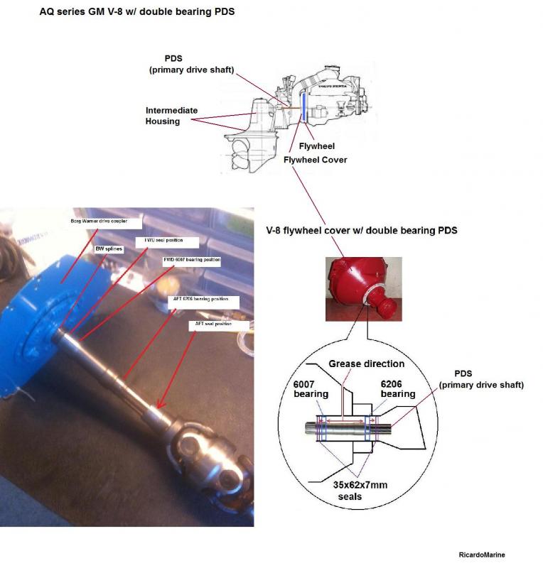

From what I can see, there is no way for the water to get into the bell housing except through the seals and bearings - is this correct?
A bellows breach will allow water into the Flywheel Cover (bell housing is an automotive term) PDS area. The water will travel through the female yoke splines and into the PDS bearing area. With the PDS spinning, the water will make it's way through the bearing ball cage and eventually into the flywheel cover interior.
Can the shaft/bearing be removed/serviced from the back of the boat without having to pull the engine and remove the bell housing.
If the boat has the original red, 1 pc flywheel cover, with a grease fitting at the 12:00 O'clock position, the answer is NO!
This flywheel cover arrangement uses a double bearing PDS. PDS = primary drive shaft.
The engine must be either removed, or slid forward and turned sideways, in order to gain access to the FWD PDS area.
With the 2 AFT snap rings removed, you will use a brass hammer (at the FWD side) to drive the PDS AFT and out.
The PDS will come out with the AFT bearing still attached to it.
You will then remove the FWD bearing snap ring, and then reach in from AFT and drive the FWD bearing out.
Replace the AFT bearing and re-install the PDS into the F/C.
Now install the FWD bearing, snap ring and seal.
Tip: either glue or stake this seal into place.
If you were to loose the FWD seal, no future grease will make it to/through the AFT bearing ball cage!
(see ** below)

The double bearing PDS can use industry standard 6206 and 6007 bearings
Get these in a US, Japanese, German, etc, ..... NO Chinese bearings!
The seals will also be an industry standard 35X62X7mm in a TCM or a Timken w/ a single lip.
The AFT seal installs in the Non-Conventional direction.
** Be sure to spin the PDS while pre-filling the grease cavity before installing the AFT seal.
Use a good high pressure grease...... not the green Marine wheel bearing grease!
The single bearing PDS can use an industry standard 6206-2RS sealed bearing.
These will be the same parts as what you would get from Volvo Penta ...... at 1/3 the cost.

This style seal actually gains sealing ability as pressure pushes on the inside, creating a further force into the sealing surface.
We DO NOT want the AFT seal to hold greater than the FWD seal holds.
Reason: as we service the PDS cavity with fresh grease, we want the AFT seal "to breach" any excessive grease volume or pressure.
If the AFT seal was to hold greater than the FWD seal, there is a risk that the grease gun pressure would push the FWD seal out of it's bore.
If we were to loose the FWD seal, we will have created a lessor resistance grease path. This means that no future grease will make it's way through the AFT bearing's ball cage.

Questions:
Do you have the red 1 pc flywheel cover w/ grease fitting, the red B/W flywheel cover with the whitish colored B/W PDS adapter housing, or do you have the later charcoal gray flywheel cover w/o grease fitting?
1 pc red F/C = double bearing PDS
B/W F/C with the B/W PDS housing = double bearing PDS
1 pc charcoal gray F/C = single bearing PDS
And again, if you have the double bearing PDS, be sure to pre-fill the grease cavity while spinning the PDS, and prior to installing the AFT seal.
You will want to see and verify that the cavity is full.
If it is not full and purged of air pockets, any future 3, 4 or 5 pumps of grease may not reach the AFT bearing as you may think that it has.
I've included a few of my images for you.
The last image shows an example of the damage that can occur from a failed AFT PDS bearing!
In extreme cases, this may include transmission damage.

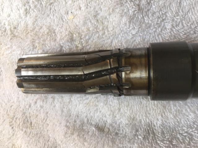

So it's a year later and the boat held up fine all season. I have it apart to replace the bearings/seals and u-joints/yoke assembly. The spindle (shaft) that the bearings press onto (#65 in your figure above, Volvo part number 839425) needs to be replaced. Is this something that you can provide/source/locate by any chance??
- Mike
- Mike
That part is the PDS..... primary drive shaft. It is held in place within the Volvo Penta Flywheel Cover (bell housing is an automotive term).
The PDS alone will be shown as NLA (no longer available). I highly doubt that you can find a good used one by itself.
You should be able to find a complete Flywheel Cover (w/ PDS) on on e-bay.
And by the way..... that particular PDS is proprietary to the GM V-8 double bearing PDS flywheel cover.
Here is a fine spline unit.
https://www.ebay.com/itm/Volvo-Pent...536202?hash=item23bab8ea8a:g:7B8AAOSwVCpcKPU8
Here is a course spline unit.
https://www.ebay.com/itm/Volvo-Pent...565296?hash=item23b969aab0:g:R0kAAOSwgsla~Hqj
Not knowing what caused the PDS splined area to twist like that, yet knowing that it had to have been a severe impact force........ I would also replace the universal drive shaft (yoke ears and center section may be twisted also).

The AQ series Volvo Penta is of Main Suspension Fork/Pivot Tube geometry, and with fixed geometry between the engine and the stern drive universal shaft.
There is no gimbal ring, no gimbal housing and no gimbal bearing.
but no one has been able to tell me what that 'alignment procedure' should be.
The one-time engine alignment involves a triangulation procedure.
The goal is to achieve equal distance between 6 flats (groups of 2 each).
NOTE: Your flywheel cover will be red. The charcoal colored one shown here is a C and later flywheel cover.... but the info will be the same.
The engine is raised or lowered, or is moved towards Port or Stbd, to achieve the equal distance between each pair of flats.
Only then are the 6 cushion ring tap bolts fully tightened.
Since there is no Gimbal arrangement that requires alignment, the triangulation alignment has more to do with the complete and even compression of the two Rubber Cushion Rings.
With the two bearing PDS I don't see anyway that the shaft can be out of alignment from the engine.
Correct!
The flywheel cover houses both bearings and it also bolts directly to the engine block. Any adjustment of motor mounts and the flywheel cover along with both bearings are gonna follow ...

As to the source of the vibration..... it's possibly a bad 6206 PDS bearing, bad drive shaft bearing crosses (u-joints), or even a twisted drive shaft component or a twisted PDS.

Although on occasion I have seen it...... it's pretty tough to twist or bend an AQ series PDS.
Nonetheless, it would have been a good idea to have checked it for run-out.
By the way, I have also seen twisted universal drive shaft components.... both in the yokes and the mid sections.
