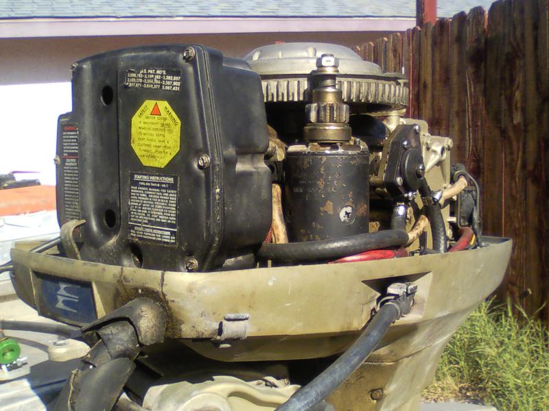

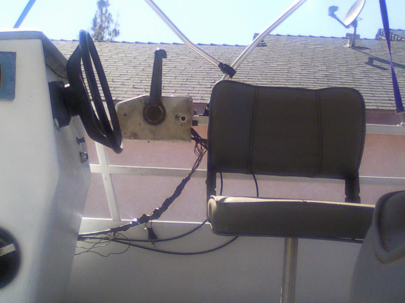

Hoping someone might be able to help. Just bought pontoon boat with 1978 55875S motor with what is an older OMC side mount control box??... Well, at least that's what the handle says!!!No tilt and trim, really no gauges...no red plug on control box and no red plug on motor. Should the motor have a red plug???? If it should, is there any way to put the red plug back on the motor? cause most of the control box that are similar have the red plug...The motor runs....just had issues with the throttle cable in the contol box, got new cable, still wouldn't work and in the meantime a few pieces broke. Some pieces are no longer available either....I'm in need of a contol box that either is compatible or a used one like it has or similar...It's a lovely wiring mess, but the motor starts etc...Just got control box issue to work out (at least for now!) Any information would be greatly appreciated. I've hopefully attached a few pics that might help out. Thank you all so very much

It should have a red plug on the motor and on that particular control box.-----------------Obviously a novice has been in there to try and get things to work.----Trial and error work and to me this usually means " mostly error "-------------Losts of good used controls available as the red plugs were used from 1973 to about 1995 on many models.
Thanks so much for the quick reply....I have seen alot of good used controls available with red plugs...any suggestions on how I replace the wiring mess with a red plug contoller and also how to hook up red plug to the motor to connect it all???
A control box with a red plug would mount in the boat and plug into the motor.-----------You have to look for / find a wiring harness ( red plug ) for the components on the motor and splice the wires in.------Just take it one wire at a time.-----You can find the wiring diagrams online.------------Depends on your location as to how much help / co-operation you may get at your local boat shop.---------Some dealers do not want to help those who are not ready to spend money.

http://www.ebay.com/itm/Evinrude-Po..._Accessories_Gear&hash=item35bff7807e&vxp=mtr with something like this and the engine harness and make it plug and play maybe look on craigs list for a engine with a blown powerhead with controls you may get lucky and get a good spare gearbox ta boot.
Power pilot control box will work.------------You need a control box with a red plug and a properly wired red plug on the motor.-----------From 1973 to 1995 a control box with a red plug will work!
