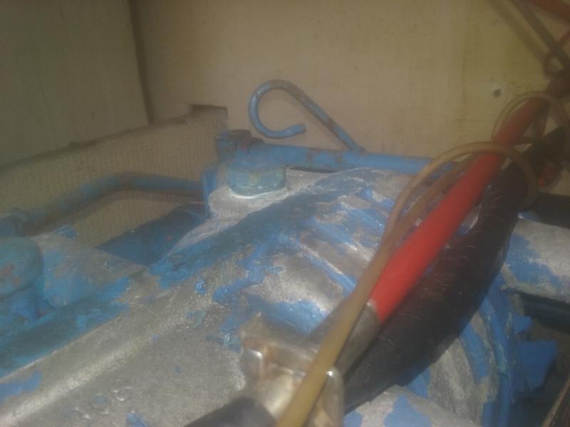

I've got late 70's vintage crusaders with Thermo Electron transmissions and Thermo Electron v-drives.

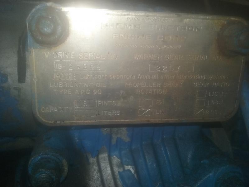

All the fluids look very clean but I want to add a tiny amount of fluid to my port side v drive. I will try to attach pics here of the tag and the v drive. There is a dipstick on forward end of v drive, but I'm not sure where to add fluid. There is a hex head plug on the top of the v drive that I am assuming is where I should pour fluid in but want to be sure. Is it??? Also, the tag on the drive specs 90# lube if you can pick that up in the pic.

My read on the tag is APG90 gear oil.....vs any 90 weight gear oil....and it looks like it was made by Warner, for Thermo-Electron.
As far as insertion point, the dipstick hole is fine.
I can always count on you, Mark. I'm guessing the APG90 translates to "all purpose gear" 90??? I will hunt some down. Yes, I could add it thru dipstick if I had to. I was hoping that hex head on top is a fill plug. Any idea on how to track down a manual or drawing on these old trannys and v drives? I've googled the Thermo Electron serial number but coming up empty. Maybe another member on forum has info on these vintage guys.
My V-Drives are circa 1990 and the fill hole (hex bolt) is on the right hand side, (looking forward to the bow of the boat) of each drive. I use a local brand of 90 oil. Just be careful and do not overfill the drives.

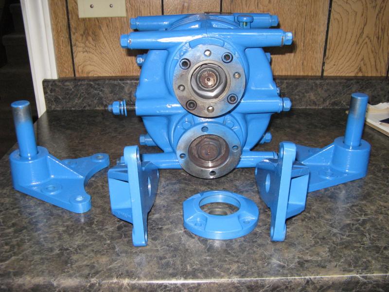

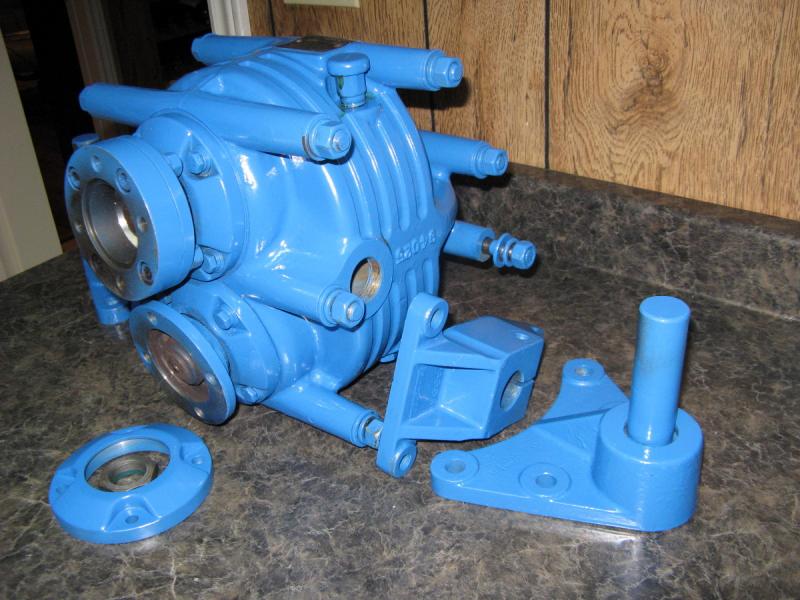

thanks willow...do you by any chance have a pic of your v drive? do you notice the large hex on the top left side of mine in photo? btw, so far (only owned the boat for the past 18 months of its 40 year life but it is performing great (other than some weird smoke it exhausted only once and for only a couple minutes a week ago). The trans and v drives appear to great. Fluids look like new and they are noise free.
Be great if I remembered left from right...:rolleyes: the hex bolt /fill hole is on the left side. All the other pieces are those that come with the drive.
The common descriptor is a crusader 4500 v-drive. I found an entry in a 2003 owner's manual that cites 80W-90 gear oil is acceptable.
