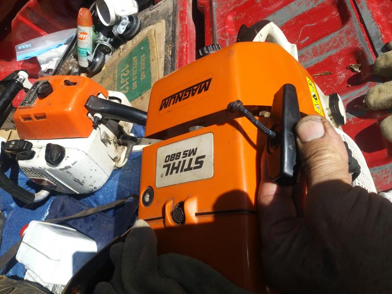

Right, Racer......these are temperamental units. I get them in for repair quite often. High performance cords can be purchased in bulk at your lawn and garden equipment retailer. I run a giant saw in my firewood business.....Stihl 880 magnum. It uses not only a decompressor but also an "elastic/rubber" end in the pull grip. The standard nylon cord supplied with the saw is inadequate for continued starting. Our local saw/garden/lawn equipment retailer offers an improved starter cord which is black and blue woven reinforced nylon. It is almost indestructible. This is my cord of choice for stubborn outboard recoils.

1020181219_resized.jpgNow, here is the best starter cord available. It will start this animal of a chain saw. 124 cc and over 10 hp.

View attachment 19017Now, here is the best starter cord available. It will start this animal of a chain saw. 124 cc and over 10 hp.
Where would I order a roll of that pull cord for my outboard repair shop. Problem I see, people don’t understand that pulling and pulling on a motor that’s not starting is not going to help. That’s when the ropes get stressed and break. Instead of pulling on it a dozen times? Find out why the motor isn’t starting within 1 to 4 pulls👍
