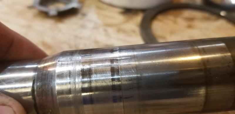

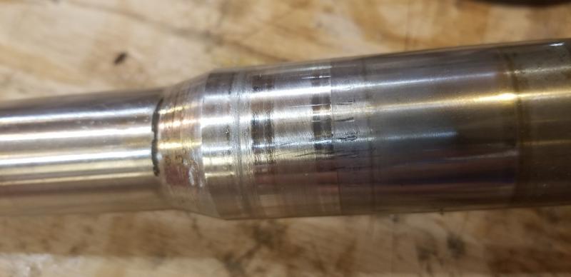

2) I also assume that the jack-wagon that was in this before me tried to get the seals out without removing the carrier. [see pics below] Is this shaft destine for the scrap bin, or do you think it could be rescued with a bit of emery cloth and some spare time? (Or other suggestions)

Pics: Note, all of the scratches are just barely deep enough that you can catch a finger nail on them.
