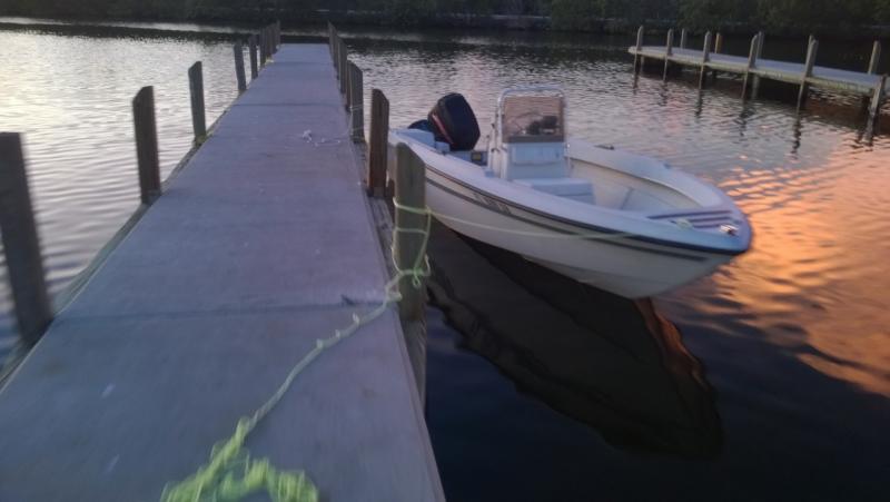

My boat is a Flare 1981 with a 2001 Mercury 90HP, engine is in great working condition, I recently took it out for a spin after a few years on the bench and the boat leans to port side as you gain speed. My questions arise from this point on, the boat literally after probably 12-14 knots goes on a steering frenzy where I have to pull as hard as I can on the wheel for it not to go completely port, the boat itself lifts its starboard side 20>30 degrees while still managing to go somewhat straight (me pulling on the wheel), regardless to say this is a pretty dangerous stunt i'd like to avoid repeating.

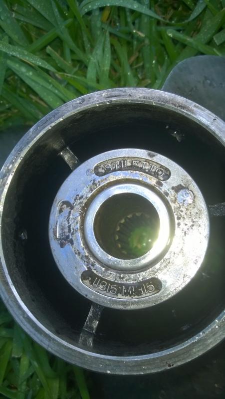

- Is it a propeller issue? When I bought this boat, the old man who owned it gave me an aluminum 3 blade propeller he had laying around from his other boat, specifically said that it did not belong to this boat, however to me it is neither too big not too small. I'm wondering if maybe the pitch or the entire propeller setup is wrong, I cannot even get to full rpms since at 14 knots I'm pretty much doing a Captain Morgan kind of stance. Buddy of mine swears this is my problem and that I should take it to a prop shop.

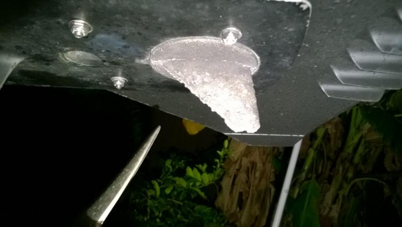

-Second question would be: is it a trim tab issue? My trim tab (Sacrificial Node) has been slowly devoured by corrosion and its pointed straight down. I've been doing some reading and aside from replacing it, I was thinking on rotating a few clicks to the left and observe the change. Could this adjustment fix my issue?
I have attached some pics of my current trim tab condition.
