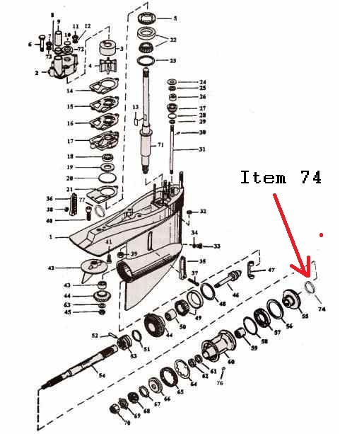

That would require a complete tear down of the lower gear case and the Thrust washer between reverse gear and the clutch dog would need review/replacement[FONT=Verdana,Arial,Helvetica,sans-serif]. [/FONT][FONT=Verdana,Arial,Helvetica,sans-serif]Thrust spacer / 23-824108

That would require a complete tear down of the lower gear case and the Thrust washer between reverse gear and the clutch dog would need review/replacement.

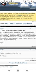

Okay just found this......direct quite from Mercruiser shop manual.
Honestly....my manual doesn't give prop shaft end play.....so not sure what manual this is referencing. If prop shaft shows .007 or more at end of splines while rotating against your dial indicator, then it is bent beyond acceptable limit.
