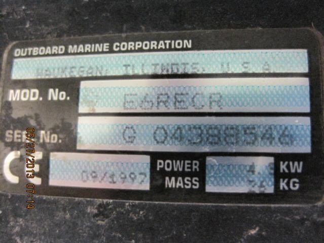

My 98 6hp Evinrude was working fine until I tilted it up to come in to shore today, the throttle will not turn back to idle postion. I had marked Idle for me and my son so we knew where it was but know it will not return back so the idle is higher than normal and hard to shift
Any ideas what happended or where I should start looking
thanks for help
