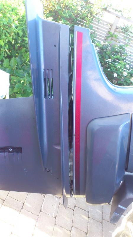

I have changed the impeller on Yamaha 150 hp HPDI, 2-stroke.
When fitting the gearbox it stops a few centimeters from the right position. (see picture)
Something prevents the gearbox from getting into the right position.
Anyone know what I'm doing wrong or how I should do?
/ Håkan

Make sure the water tube is lined up.-----Have an assistant slowly rotate the flywheel to lineup the crankshaft splines with the driveshaft splines.
