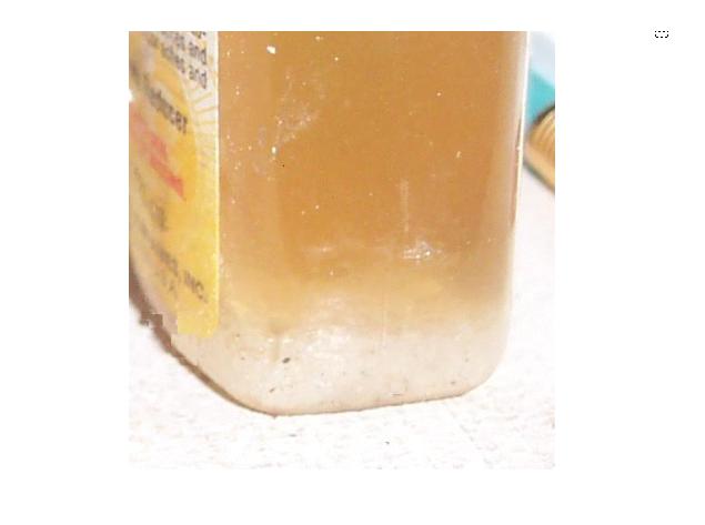

Thank you for your service, and I'm really sorry you're having so many problems. It's a shame you fired the motors up on that old fuel, but too late now. What's happened to the fuel in the tanks is that the ethanol has formed a third liquid (see photo) that will not burn (and no known additive will fix it. Note that this 'white gook' is heavier than the gas, so it settles in the absolute bottom of the tank and is hard to get ALL of it out.) So, the entire fuel system will need to be thoroughly cleaned out.
