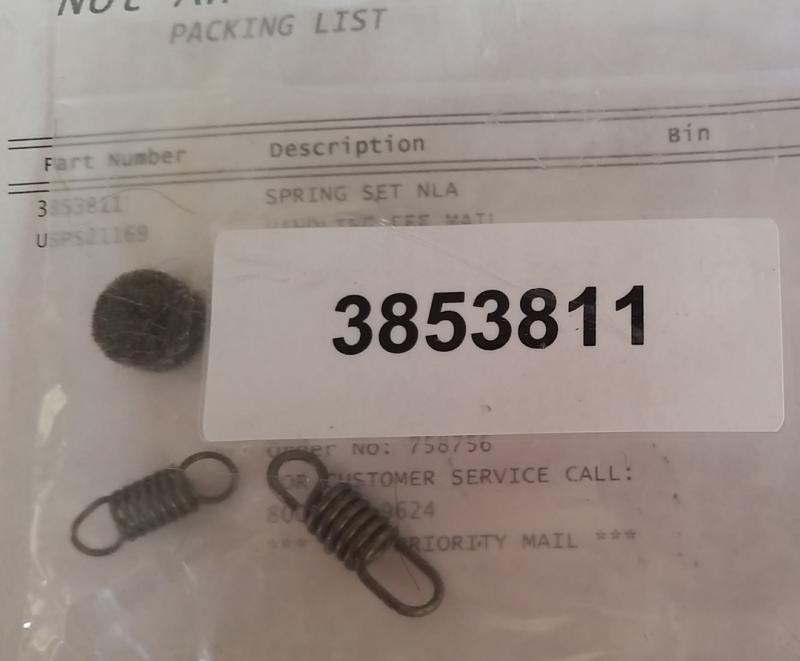

The only new replacement springs that I found that were compatible. Available here and in limited quantity.

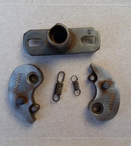

Originals compared to replacements. A very good starting point. BTW the slots in the yoke are 1/2 an inch long.

View attachment 18760View attachment 18761

Please carefully read post #4 in that thread.
I cannot emphasize enough the importance of checking the advance curve on a Sun, Allen or King distributor machine when replacing the flyweight return springs!
The provider may be well intended, and may tell you that these are the correct springs for your application.
However, one small difference in spring value can make a huge difference in the advance curve!
