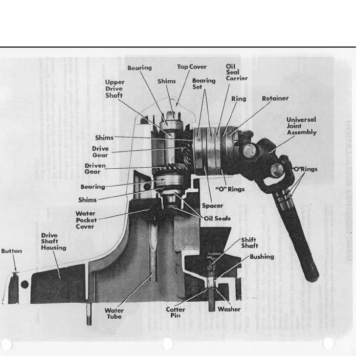

I have a 1977 Pre Alpha. Had some issues with it shifting into gear and working good. Then after a warm up or about ten minutes of running it would shift into neutral then not back into gear. Or it would get stuck in a gear and not shift out of that gear. Took it to a shop and was told the lower was bad. So went and picked up a low hour complete unit from inner transom plate to prop. I swapped out the lowers and had the same issue. Tore it down and found the lower shift cable housing gone and the wires frayed. The inner cable just doing what it wanted. So over the winter, I removed the bell housing and replaced all the stuff that needed replaced. Bellows, bearing, trim sensors, water impeller(again due to shop running unit without water) and lower shift cable. Cleaned out all the very old grease and sand. Put it all back together with fresh grease and as clean as I could get things.
Removed the drive with the remote in forward gear like the Clymer manual said. Reinstalled the drive. And can't get the cables to adjust like the manual says. Took the lower back off and after looking at this and the other unit, things just don't seem right. The sift rods are both great and feel tight. No play and move great. The "U" is nice and tight and the foot is great with nice clean edges. The cam and arm are tight and work as they should.
What is driving me crazy is this;
Lower unit, at 12:00 locked in reverse prop locks CCW looking from aft to front.
Lower unit, at 10:00ish locked in forward prop locks CW looking from aft to front.
Upper unit, 12:00 remote in forward WOT shift cable plate in full forward.
Upper unit, 10:00ish remote in reverse WOT shift cable plate in full reverse.
I have gone back and forth looking at the "spare" unit and the one in the boat and both are the same. Now from the boat side it's just as the manual says it should be. But the drive is not what it says it should be. It came off the boat and was running before hand.
What am I missing here?
