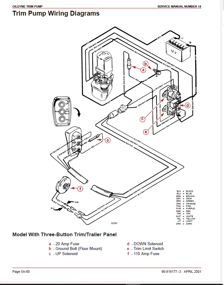

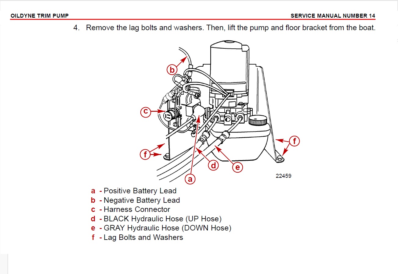

The following are three images, one is he new style image of the pump assembly, the other two are the schematic for, The new assembly and the single solenoid old assembly.
Best of luck
NOTE: In image two the schematic,
The manual had a mistake.
F is the trim limit switch.
E is the Down solenoid.
D is the 110 amp fuse. This may or may not be on your assembly so do sweat this at this time.
