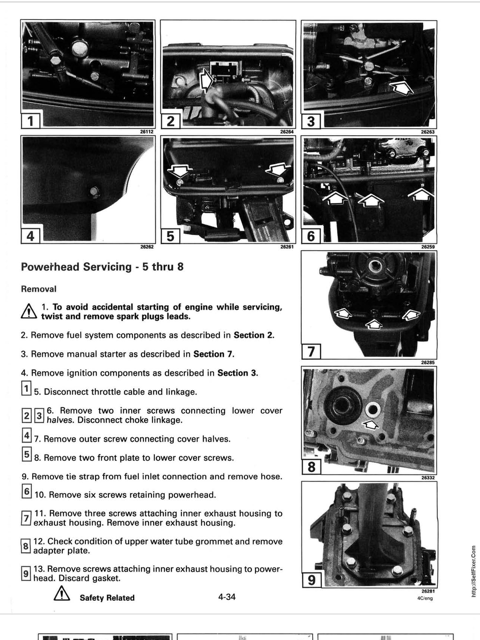

PS if you want a factory service manual, PM me an email addy & I’ll send you a link. It’s for a 1994, but they should be Similiar.
I assume you have all the connections undone, here’s what the ‘94 model says.

Bingo! I used an old wood chisel in the front of the power head between the power head and the aluminum base plate and was successful in separating it. Thank you for your help.
