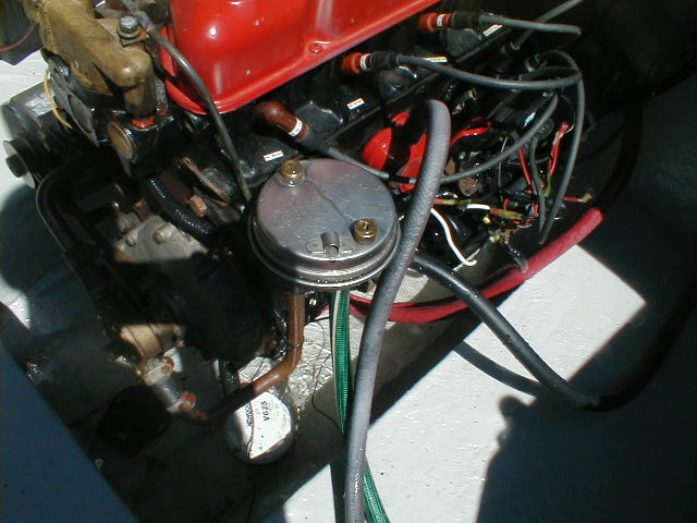

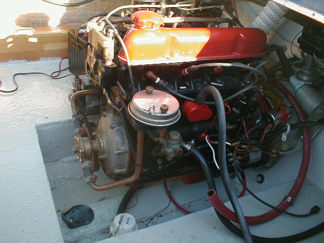

Take a look at these pictures and try to describe the hole you're talking about a little better. Most of the bolt holes you see are empty and they would not be the source of the leak. There is a small brass tube going from the bottom of the thermostat housing to the head. This one requires a square o-ring. Look closely to see if that is the source of the leak or the housing o-ring itself.

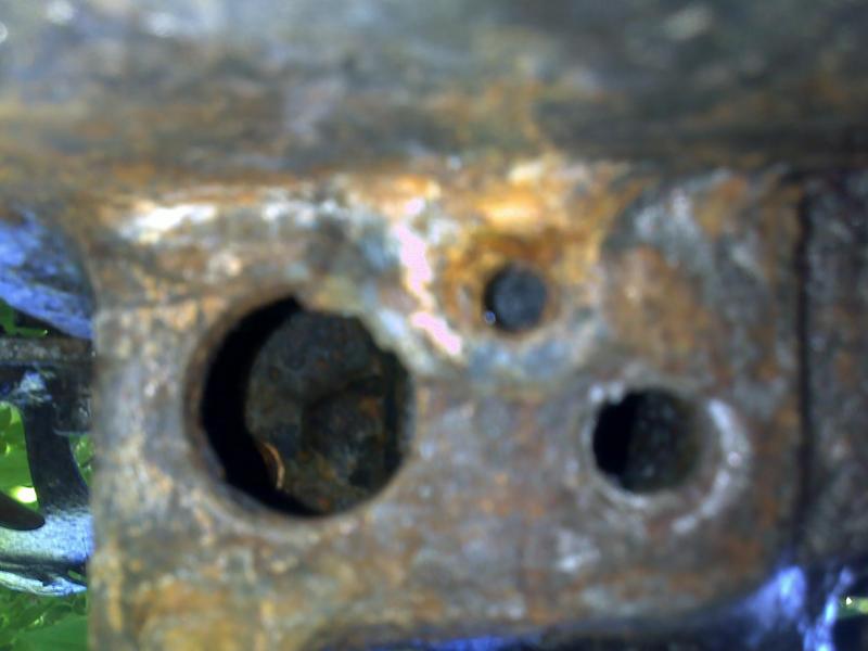

Here is the pic of the hole I mentioned this photo was taken lying on my back looking up under the thermostat housing
Looking at the pic on the lower left corner is the broken bolt, the hole to the right of the big hole I think is a water bypass for use with the auto mechanical pump, looking at the big hole I reckon I can get away with fitting a freeze plug there is enough thikness inside to support it, the bolt hole I can just put the old bolt back in and the bypass hole I can turn up a blocking plug out of brass stock to plug that so hopefully an easy fix

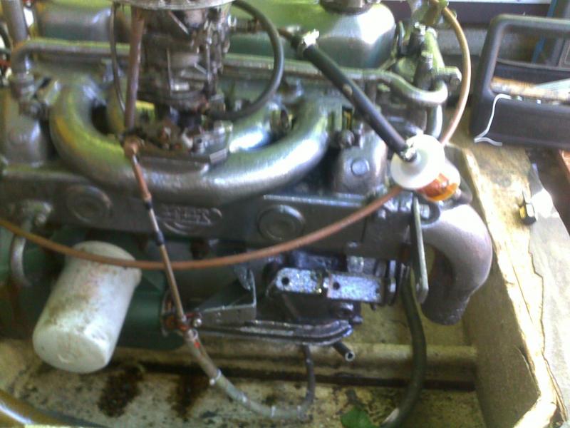

This pic just shows the water cooled exhaust manifold and the cooler, a question about the cooler I assume to remove the cooler of the engine once the filter is removed the thread for the filter has a nut on it which I just unscrew and the adaptor cooler will come off?
I'll try to get a look at mine in the next few days to check on the underside of the thermostat housing area. You're right about the oil cooler. Large nut attaches it to the block. Those o-rings are available as a kit but can be purchased separately. If you're going to the trouble of removing and disassembling the cooler, would be a good idea to take it to a radiator shop and have then pressure test it for you. I had one done a few years go and it only cost $20.
