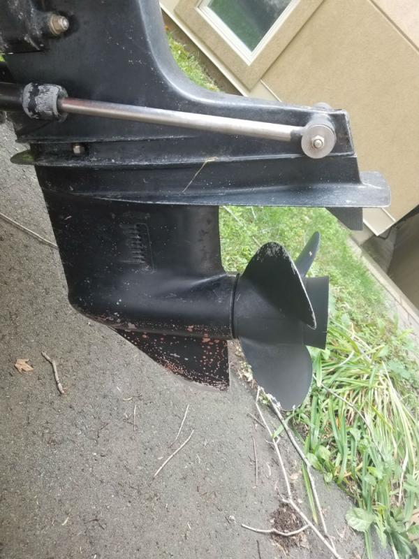

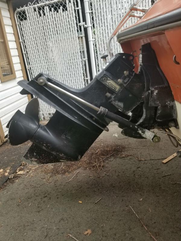

Hi! Please help me to identify this drive :)
i need to get a new impeller. I'm pretty certain the upper unit is an MC-1 (pre-alpha) because of the ribs near te oil vent and the loop at the very top, but the cavitation plate on the lower unit is more square than round so that makes me think it is an Alpha One Gen 1.
Only reason i think it's Alpha One Gen 1 is because it's the only model i could find that is compatible with the MC-1 upper. Do you know of any other lowers that are compatible with the MC-1 upper?
anyhow, have a look at the pictures below to see for yourselves
cheers!
could be a mc1 upper and a R lower or a MR lower . cavitation plate is flat not rounded like a MC1 Drop the lower and remove the pump base and post the pics

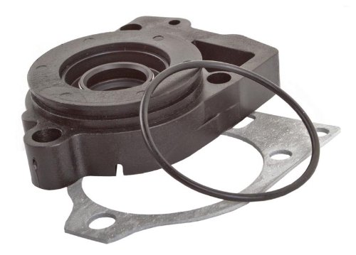

Without a pic of the bottom of the water pump base , it cant be positively ID`d
This is a ,MR type
THe White base is R, MC1 type
