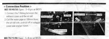

I have bought 40 hp 4 stroke Tohatsu last year ( the motor is 2021 I think), installed it earlier this year and got stuck with water pressure gauge 3GL725980M installation on the motor side. It came with the paper instructions with black/white picture and I simply can not figure out which part of the motor is pictured. Never had large outboard before.
I can not find any instructions on the web so all I have is this picture (attached).
It very well may be that the T-fitting goes into pissing tube but I would rather ask someone who knows what they are doing before cutting the wrong tube.
Any help would be greatly appreciated. If someone has a similar motor and could send a photo of the engine part pictured in the installation instruction that would be ideal. Thank you for your help.

Those instructions are for a TLDI motor. You have an MFS40A most likely. Year is irrelevant; model is everything. I have never seen a need for that 10 psi gauge. But it's doubtful the pee tube will have any measurable pressure. They usually install near the thermostat housing.

That is correct, I have MFS40A. I looked up on Tohatsu US website and it says this gauge is compatible with MFS40/50 and all tldi models. The instruction lists only MD 30B2/40B2. I suspect MD models are for EU market, at least this is what the manual says for those models.
With all this said, maybe you could advise what side of the motor is pictured? To my shame I do not know how air rail looks ( or exhaust cover) and can not find any meaningful schematics. Thank you.

Got the reply from Tohatsu, "T" goes into pissing tube, just a couple of inches above discharge hole. Installed, will check how it works.
