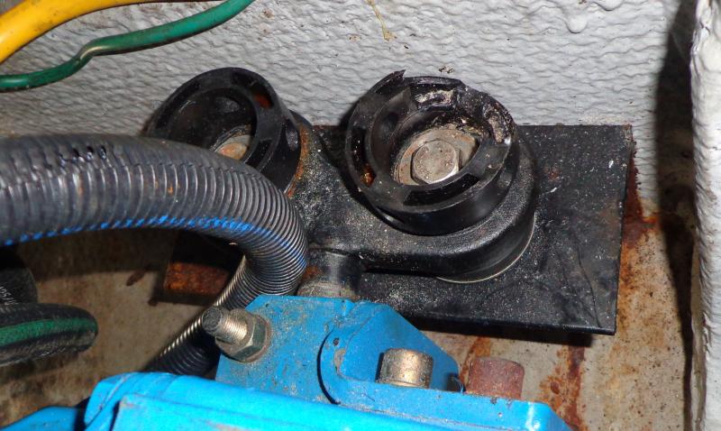

Is there a special procedure for adjusting the mounts that have two of the plastic adjusters for raising or lowering the engine? Adjust both about the same amount so the pressure on each is the same? Note how someone has already broken the plastic cap on the right.
How about moving the engine left or right. Is the engine mounting bracket normally slotted to allow some movement or is the engine slid on the rod section of the mount that goes into the engine? Does that nut and bolt near the middle of the picture somehow clamp the engine to that rod?

Ideally, you want to keep the dual adjuster parallel to the stringer service, so yes, adjust both threaded adjusters equally...with the broken adjuster, it may be easier said than done.
for left right adjustment, the adjusters are fixed to the stringers. What you called the rod is formally called a trunnion. they to are 'fixed'. The engine/gear slids left to right on the trunions and the "nut and bolt" cause a clamping down action on the trunnion to stop further movement once adjusted.
You can correct the angular alignment of the engine to the prop shaft by articulating the dual adjusters on the vee drive independently, ie: if your shim stock is unequal from left to right, but equal from top to bottom.
Sorry but I don't understand. Can you please elaborate and also what do you mean by "shim stock". They are V drives...could you tell that just from the photo...or do only V drives have the dual adjusters?
