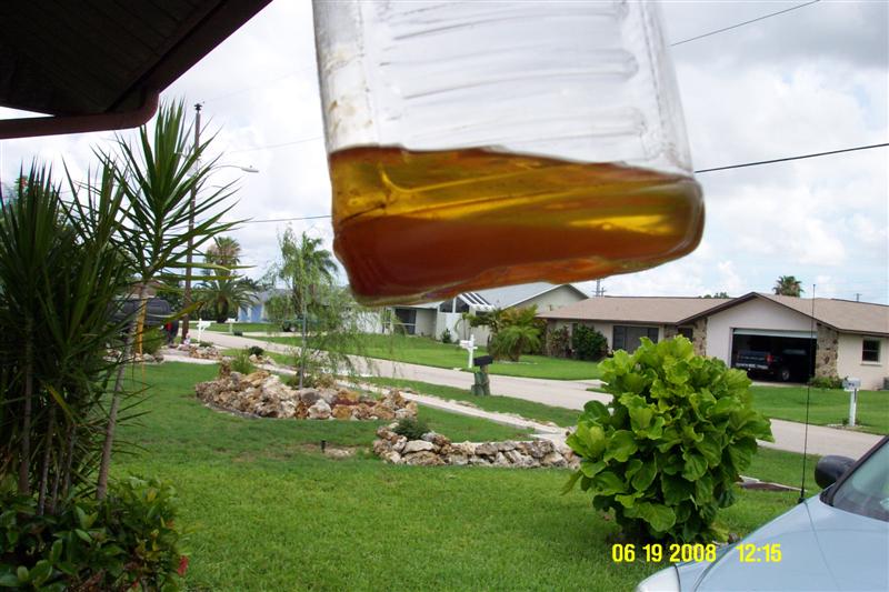

This was gas right from the gas station. I slowly decanted the three gallons purchased for my motorcycle until I got down to one gallon. This was the result. Phase separation.
