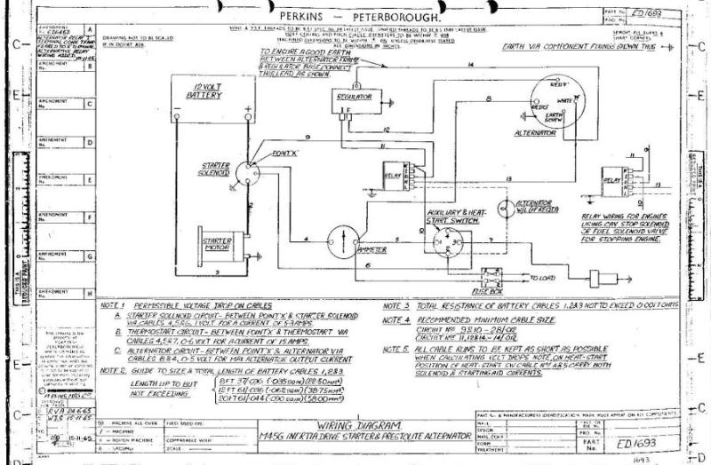

to complete the electrical circuits in a sailboat that a client has built himself and bought a completely renovated perkins in. Unfortunately the engine is very old and has dc generator with regulator and misc. stuff that I removed and replace with ac. In Sweden, I can not find a eletrical wiring diagram for this engine. Is there anyone who can help me to fine a elektrical wiringen.

Bad English I mean wiring diagram for 4.107
I can take a copy of the original schematics to my Perkins 4-107 for You, I have it in the boat. It is based on a Prestolite American charging system with separate charging regulator but it is pretty straight forward to convert it to a modern integrated alternator.

This is the wiring diagram we kept since installation of the engine in 1967.
