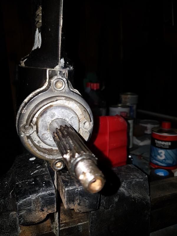

Hi! Im new here and from Sweden. Got an old used Force 35hp cheap in parts. Engine runs but the lower end was taken apart when i got it. So I changed the water pump but im not sure about how to put it together.
There is a metal ring high up on the drive shaft that is really stucked. Should it be up there or should it be on/over the water pump housing ? I also have a Loose rubber ring , cant figure out where to put it. Its the same innersize as the drive shaft. About 0.5 inch lenght
There is missing two screws on the lower end behind the propeller, the tapped holes are like 0.39 inch deep. Is something missing there where the screws should attach something?
Force motors are extremly rare in Sweden and I cant get no information here so im glad if you could help me. Tanks

Wow Thank you Jerryjerry05. I Guess the anode is not necessary? seems like the previous owner drove without it. Its Only being in sweetwater.
Should i move up the ring so it is just under the splines and the put the rubberring on the top of the metalring ?
The ring should be able to come off with a bit of upward pressure.
Cresent wrench and a hammer.
The ring is the second part of the spline cover.
It's rubber and fits up on top of the splines and sets on the metal lip.
The 2 holes.
They are for an anode.
Sacrificial zink.

Found a pic on Internet, its a 89 but the metal ring is at exactly same place as mine so I guess I just leave it there but put on the rubber ring on top.

Put some grease on the splines just a light coat you dont want too much it can cause it to hydraulic and put pressure down on the pinion gear in the gearbox and cook the gears and crankshaft thrust bushings. Dont move the retainer it pushes the seal into the crank to keep water out of the splines.
The ring only sets in one spot.
You'll need to remove i to change the pump.
Then just slide it back on and then grease then the cover.
In fresh water you don't need the zink unless you have a short in your
electrical system.
Some short out and cause galvanic corrosion and the electrolysis can actually eat the drive.
