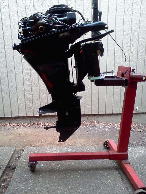

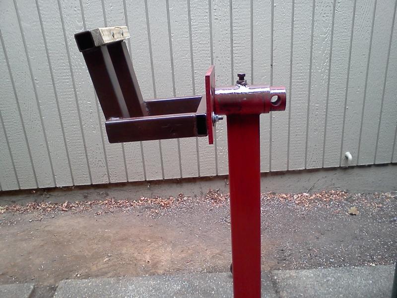

Worked on the motor and the stand I built to hold it....remember transom brackets are broken. Hand pulled and got the oil light on each pull. Oil light comes on whether start button is out or not......is that correct. No spark to the plugs. Started rechecking the wiring found the fuses slightly corroded - pulled and cleaned - still no spark. Anybody have a wiring diagram that shows what the output values.
My first rig to work on the motor and now the newer stand. A better view of stand in last pic.

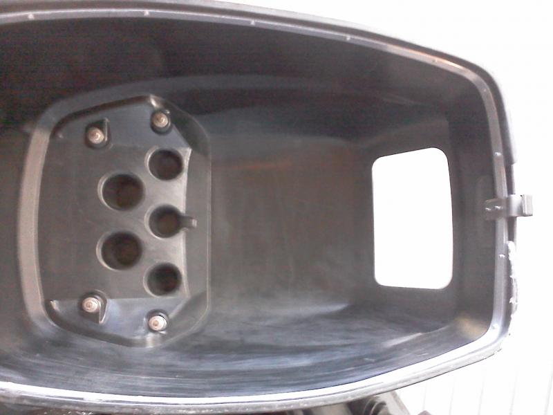

The cowling gasket had been attached many times and the glue has never held. Cowling was held on by duct tape and latch was missing as well. I talked to the local rep who had worked on the motors over the years and he has glued them many times and nothing holds for long. We have the reduced voc cements in California to save the environment so we get to use them over and over which probably ends up being worse. I tried the flex seal stuff didn't hold. I decided to put some crazy type glue on it and then rivet an aluminum flat bar to hold it, worked very well. I beveled the bar in spots (mostly the back to slide down more easily when latching) after riveting since I have bits and die grinder but would do it before installation if I didn't. Painted and done, shown before paint here.110414120643.jpg110514151523.jpg
Nice job! We replace those gaskets, as they shrink over time, and never re-glue well, even with good glues.

Thanks for the cowling attaboy. If others try it I recommend bending it first to loosely fit then cut off the excess as you get to the latch plates and before the last rivet. I started riveting close to the middle and worked toward the bends tapping the material into the bends adding clamps to hold it then doing one rivet right at the bend. Material was 2 ea. 1/2 in x 36 in Al flat bar 1/8 in thick.
Nice to have it fit well now. It was the worst of the 4 in the lot and had some sketchy work. I think the recoil mechanism was set on top of the bolt collar and then it wouldn't fit right so the latch clamp was removed or lost. You can see in post 3 pic the duct tape marks on the cowling.
