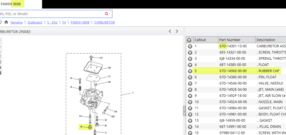

Here in the US the last F4's that used a rubber plug below the main nozzle was the F4MS/LH models.

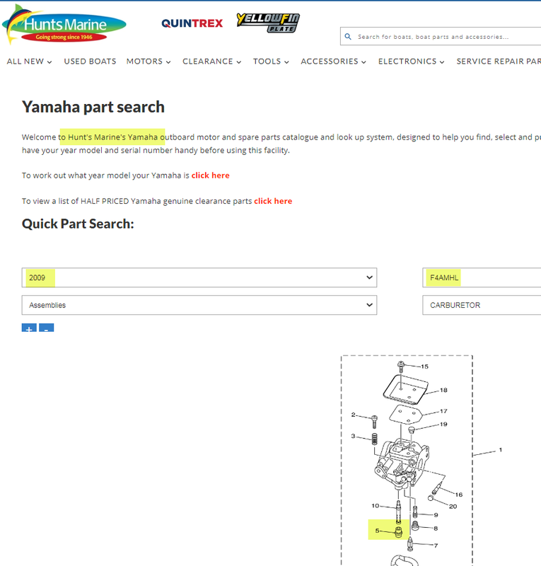

Here is an illustration from a Yamaha Australia dealer that depicts the same carburetor but for the year 2009. Looks like in 2010 a different carburetor type was used.

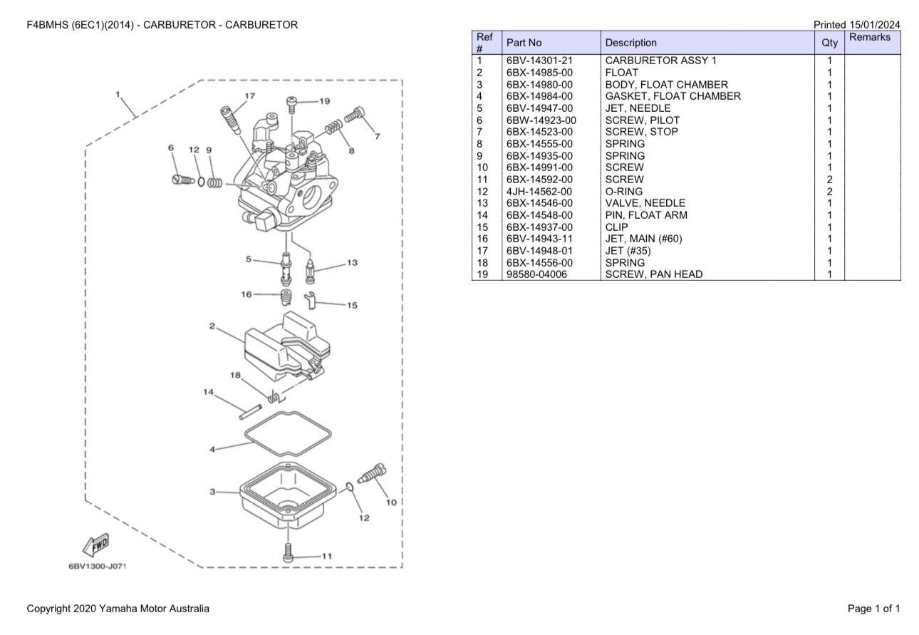

Thank you Boscoe. My carburetor Is different to this one from Hunt Marine. The attached diagram from Yamaha Australia does depict mine, but does not show the rubber/silicone element that came out when I removed Item 5 (6BV-14947-00) from the carburetor chassis.
My carburetor is marked on the body KEIHIN JAPAN and on a flange 6BV 2E J with a final character that’s not English.
None of the illustrations for any of the 6BV carburetors show the use of a rubber plug or cap.
Explains why Yamaha Australia could not help.
