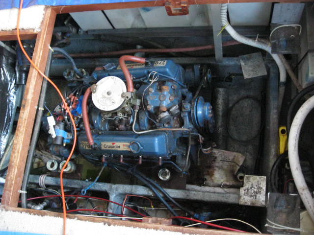

A pic of the HX, in addition to the T-stat outlet, would help...also, any idea as to the old vs new engine/block that was recently replaced?
IMG_0573.JPG I can't get the pictures I took (with an ipad) for this to post, so am trying some old ones I took with a camera. If posting them works I will take new ones (more specific to the thermostat and cooling system) with the camera and post them. These are shots I took of the old motor when I was taking it out. Everything looks the same now but I don't know that you can see what you want to in these. the first should show most of the cooling system (without hoses). You can see the thermostat housing in the second one but the heat exchanger is gone.

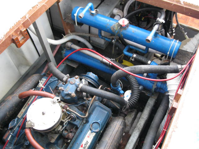

KAG, I'm not understanding what looks like two heat exchangers. Perhaps you can explain this.
I think that your T-stat housing has been adapted from a RWC system T-stat housing. Two ports are apparently closed off.
I'm also wondering if the steel plumbing parts, and the number of bends and elbows, are restricting coolant flow.
The corrigate Circ Pump supply hose may be somewhat restrictive.... not sure, but these are usually smooth pre-formed suction hoses.
The exhaust manifolds are in the CCS loop, but I do not see the return-to-H/E lines.
All in all, it looks like an overly complicated closed cooling system to me.

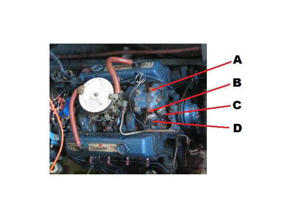

KAG, I need to preface this a bit: I am not familiar with your system. I am, however, familiar with the Closed Cooling Systems in general.... and certainly with the RWC systems.
see first attached image at bottom of page:
A and B would have been for the raw water leaving the engine as per what the thermostat dictates.
These are NOW for the coolant-to-exhaust manifolds (according to the hose routing in the other image).
Let's hope that between these two ports, that they are dividing coolant flow equally.
(again, I do see any exhaust manifold-to-H/E coolant return hoses)
C would have originally been the Raw Water supply.
D would have been the Circ Pump suction hose connection.
see second attached image bottom of page:
(it's not quite the same as yours, but the internally porting should be very similar)
The issue with an "open" system T-stat housing (now being asked to work in a CCS) is the way in which these are internally ported.
With a RWC system, the T-stat housing allows most all sea water to by-pass actual engine cooling demands, and directs most of this into and right out the exhaust system. (this occurs within what may be called a mixing chamber)
The engine Circ pump is constantly pulling on the large port (D), wanting to "charge" the engine block with cooling water.
The actual thermostat allows the water to leave the engine block/heads as required...... (very much like with a CCS)
I believe that your T-stat housing is actually designed for RWC'ing.
Blue = incoming sea water
Yellow/blue = water from the mixing chamber going to the Circ pump
Red = tempered water leaving the block/heads
Red/Blue = tempered water mixing with by-passing sea water going to the exhaust system
I don't know what affect this additional porting may have on your CCS, but IMO, there is no need for ports C and D in your system.
Also....., I'm not suggesting that this is your over-heating issue, just say'n that I don't believe that this is the correct T-stat housing to be using on a CCS.

Rick: I tried again this morning to post better pictures. Since old pictures in my computer taken with a camera posted, I tried taking pictures of the pictures on the ipad, didn't work (wouldn't post). I have two teenagers and none of us have yet to figure it out.
Anyway, I think you are right, the housing is a carryover from the old system, but seemed to work fine. With those ports (your c & d) blocked wouldn't it function the same as the one you pictured? In your thumbnail two posts up you mention that the return to the pump from the H/E is usually from the lower port. Mine doesn't have a lower port. Coolant enters the top at one end and exits the top at the other end.
Hoses (missing from the picture) run from the aft end of the exhaust manifolds to the H/E, which has two parts. The top cylinder, where the hoses connect, simply collects the coolant, which then gravity feeds into the lower one, which is where the tubes are and the actual cooling takes place. Elbows etc. are steel (good eye) but all the ones I have examined are clean, with no rust or corrosion (in or out). The cooling system has always seemed to me to have an inelegant, homemade appearance, but worked. Maybe it is marginal and, because of the way it is made (hose sizing, ribbed hoses...?) everything has to be perfect, so if the tubes are a little dirty, or whatever, the engine runs hot. If so, I have to figure out what else isn't perfect, or redesign or replace the system.
On the sea trial when I bought the boat (7 seasons ago) this engine was running hot. Part of the deal was that the H/E be cleaned. I don't know what was actually done but the temps were fine when I took delivery.
I don't see why it would matter but feel I should mention that this engine is reverse rotation.
1.... Anyway, I think you are right, the housing is a carryover from the old system, but seemed to work fine.

1.... OK.... so if I understand you, the upper unit is serving as an expansion chamber or a coolant reservoir only.
The lower unit is the actual Heat Exchanger with the tube bundle.
Looks rather small for what's called a "Full Closed System".
None of my biz..... but I don't like seeing those galvanized steel pipe pluming parts, nor the amount of bends and elbows, nor the corrugated circ pump suction hose being used.
From my limited Hydraulics/Pneumatics experience from years ago, small ID, bends, elbows, distance and perhaps corrugated interiors = flow resistance.
Question: Are these OEM Crusader patterned systems, or are these a home version?
As for the T-stat housings..... your call on that.
If this was mine, I'd be changing them.
The engine being a RH Reverse Rotation means that the Circ Pump must be RH Rotation capable.
These are centrifugal pumps, and will usually function in either direction.... however, some casting porting causes them to NOT work as effectively for RH rotation.
You can purchase a RH rotation specific circulating pump, or what's called "bi-directional".
This circ pump is either rotation capable. You'd need to look closely in order to see the difference in the castings.
I can't explain why this worked when you first took delivery 7 years ago, and why you are now having trouble. Perhaps things are closing down due to rust scale, etc. Don't know.
I do know that when converting a previously RWC'd engine to a CCS, there are inherent and potential issues that must be addressed, or they will eventually haunt us.
We also know that you need to correct this before you see some serious engine damage occur.
I'd suggest that what ever you do to the RH engine that corrects this issue....., you also do same to the LH engine.
2.... I agree. This is why I suggested the rust scale build up around the tube bundle, and is why I suggested having these serviced.
As for redesigning...... if the H/E is on the small side for a "Full System", is there any consideration that you would remove the manifolds from the CCS loop, and RWC them instead? This would be what's called a "half system".
Here's part of my thoughts;
Your twin SBC engines are undergoing a work load not all that different from other twin SBC installations. We'll see some differences in H/E configurations, but all of these OEM systems are capable of removing the engine produced heat.
It's not too much to ask of your cooling systems to keep your SBC's just as cool as any other systems.... as long as they are up to snuff.
So..... yours are either NOT up to snuff, or there is a design flaw, or possibly a mix of both.
Not up to snuff = sea water pump issue, suction hose collapse, restrictive exhaust water flow, H/E tube bundle issues, etc, etc.
Design flaw = some of this rather unorthodox plumbing, incorrect T-stat housing, undersized H/E, etc etc.
It took a day and a half, but I pulled the heat exchangers from both engines and swapped them. The one on the behaving engine had some rusty bits in it. What is really interesting is that when I drained the collection cylinder on top and the hose going to the pump (so coolant just before and after H/E) it looked normal. The coolant from the H/E itself was discolored. Like it had just become a problem. I would have expected, and can't figure out why it wasn't, that all of the coolant would be the same color. The engine was run a few days ago and the rust is probably from my trying to flush the manifold a month ago. I also found some sealant inside a pipe that was probably from its assembly who knows how many years ago, but I am sure it restricted flow somewhat. But all that was on the engine that is doing fine. The other one came out clean.
So today, day two, in the rain, I took it for a ride. Judging by the gages only it appears that it ran cooler by maybe five degrees, which was picked up by the other motor. So I would have to say that (the formerly) rust filled H/E (I did flush it out, remove the ring of sealant and scrub the tubes while I had it out) works slightly better than the other one, but the same engine still runs too hot, about 190 at 2900.
So, to recap: I don't think it is raw water flow (which includes the impeller, raw water pump, restrictions in the intake, etc.) because the volume is basically the same as the other engine and I don't think it is the H/E because I swapped them with very little difference. So the next step would be to replace the coolant pump? Do they ever go a little bad or do they just fail?

KAG, I was going to post a few images of the SBC circ pump interiors for you (shaft/bearing assembly/ceramic seal/impeller) but since there are so many arrangements, I decided not to confuse the issue here.
The Marine SBC uses the short body GM circ pump housing design from 1955. These were not ported for heater core coolant return until a few years later.
These use a steel impeller and do not hold up well under Raw Water cooled engine usage.
The Marine version circ pumps not only uses the bronze or SS impeller, but are also bi-directional.
(don't confuse bi-directional with reverse flow of the mid 90's automotive)
If the previous owner used the automotive pumps, and did not bother to change them when he installed the Closed Cooling systems, it could be that the impellers have become corroded and compromised in their ability to circulate coolant.
I'd remove them and remove the rear covers.
You'll be able to see what impeller material was used and/or the condition of the impellers.
For your LH Standard Rotation engine, you can use the less expensive automotive short body circ pump.
However, for your RH Reverse Rotation engine, you'll want the bi-directional Marine pump.
So, if you were to replace these, you're looking at about $30 for the LH engine, and about $70 for the RH engine.
If you replace these, they can be checked off of your P of E list.
Another sunrise trip to the boat, this time to pull the water pump (engine, not raw). It is a GM pump, #3839175, which seems pretty standard. The impeller is stamped GM 6269981 MB. The shaft appears to be ss and the impeller bronze with straight fins. Which, I think, makes it a marine, bi-directional pump (right?). There is no apparent physical damage and it spins freely. Other than out of desperate need to do something, I don't think it needs to be replaced, unless I am wrong and it is the wrong pump, in which case I would need some advice as to what to replace it with.
As far as I can tell, with the thermostat in, there is no circulation of coolant, at all, until the thermostat opens. There is circulation on my other motor, which has the same style housing. I assume, based upond comments above, but have not checked, that there are holes in that thermostat. I am going to try and get one with holes, or drill some in the existing one, unless advised to the contrary. I don't think this has anything to do with my problem but don't like the way the temp shoots up until the tstat opens.
I have not seen others, but mine came with three holes of about 5/16". Spaced equally on the vertical non moving part of the thermostat. I bought a replacement that had two holes, slightly bigger, so I don't think it is too critical.
CaboJohn
KAG, it sounds like the bronze straight fin impellers are correct for bi-directional useage.
If they are both tight to the shafts, and if not compromised, they should be OK.
However, if this pump is for the Rev RH rotation engine, the pump body (cast housing) must also be correct for reverse rotation.
You may want to compare your pump body to one that is known to be correct for Reverse Rotation.
Be sure to install new cover gaskets.
As for the thermostats, the small holes are air bleed holes. They aid in releaving a freshly filled system of air only.
You should not need to increase the size nor the amount of these air bleed holes. The single tiny air bleed hole should be sufficient.
Correct! There will be little to no coolant circulation until the thermostat begins to open.
The circ pump is continuously charging the engine block with coolant pressure..... (mild pressure, I may add).
Once the stat begins to open, we then see coolant leaving the block.... I.E., coolant flow.
Since the stat begins to open only upon sensing temperature, engine temps may increase rather quickly at first.
If temps taper off and hold within operating range, I'd consider this to be normal.
there should be a minor bypass around the thermostat...the correct housing will have that port integrated within it. Drilling the t-stat is another way of getting the same function albeit not preferred. This bypass will provide a minor amount of circulation which may or may not be visible given your unique arrangement.
the circulating pump with the "straight" cast impeller will work rotating either way...you should be fine there.
