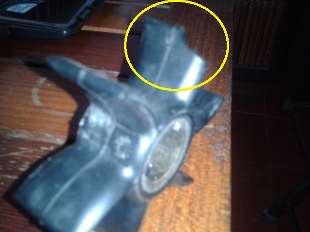

I bought mid 2011 Two Mercury 50HP 4 STROKE EFI 50EFI ELPT 4
One run perfectly.
[/SIZE][SIZE=-1]the other one has to be turn off[/SIZE][SIZE=-1] after 20 mn of use [/SIZE][SIZE=-1] [/SIZE]
[SIZE=-1]Overheating is the problem.
Impeller? engine is 38 hours at the hour-meter and this problem occur almost the first week of use.
Water pump impeller ? Yes , there is something on that side.

Of course I do not get water from the tale put from water stream at the exhaust passage.
WE removed the impeller and we an see it is broken. I ned to change it and will back to yo if the problem is resolved.

Overheating problem has not been set even if I had to change the impeller.
In fact problem came from the thermostat , blocked with sand,salt and seeds.
I cleaned with vinegar and everything backed to normal.
