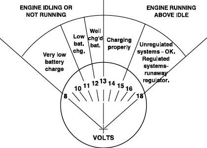

Here's a good reference I took from here.
