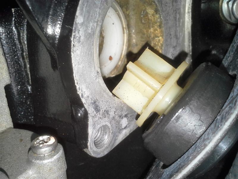

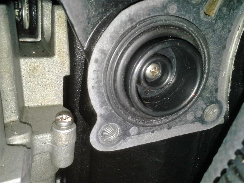

Is the Mechanic installing the popit correctly? Maybe you should take the popit apart and take pictures of the assembly so we can see it.
Your issue sounds like a popit problem.
20160801_143224 (2).jpg20160801_143229 (2).jpg20160801_143254 (2).jpg20160801_143301 (2).jpg20160801_143306 (2).jpg
it takes about 15 minutes to warm to any temp not even close to thermostat temp
thanks for the picture but I have a service and repair manual for that model, have surfed the net for pictures
I shall try again and put back the popit valve/thermostat and try to run it again
