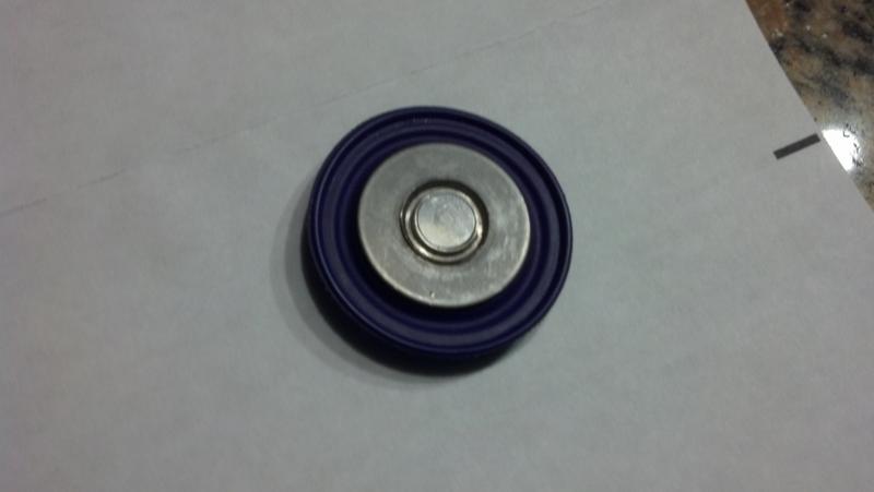

I got the new rubber diaphragm from a new tracker valve. I needed one tracker valve because mine was torn (after 12 years of wot runs) and I ordered a second to repair the fuel regulator diaphragm. I removed the diaphragm from the tracker valve the same way I removed it from the fuel regulator diaphragm assembly.

Once the washer is off, replacing the rubber diaphragm is a snap. Then you replace the washer and using a different tool, you bend the swedge back in place to hold the washer. The second tool you will need is another 10mm socket. Grind out the inside diameter to clear the center bearing, then chamfer the outside to 45°. I then placed the tool in the proper location and put the tool and diaphragm assembly in a 4” vise and squeezed everything into place.
dsc01015-640x360-jpg.286
I made sure that the swedge was bent the right amount by comparing the original height of the assembly at the swedge to the ‘repaired’ height. The washer sits on a shoulder on the core and ensures a perfect fit to the rubber diaphragm.
