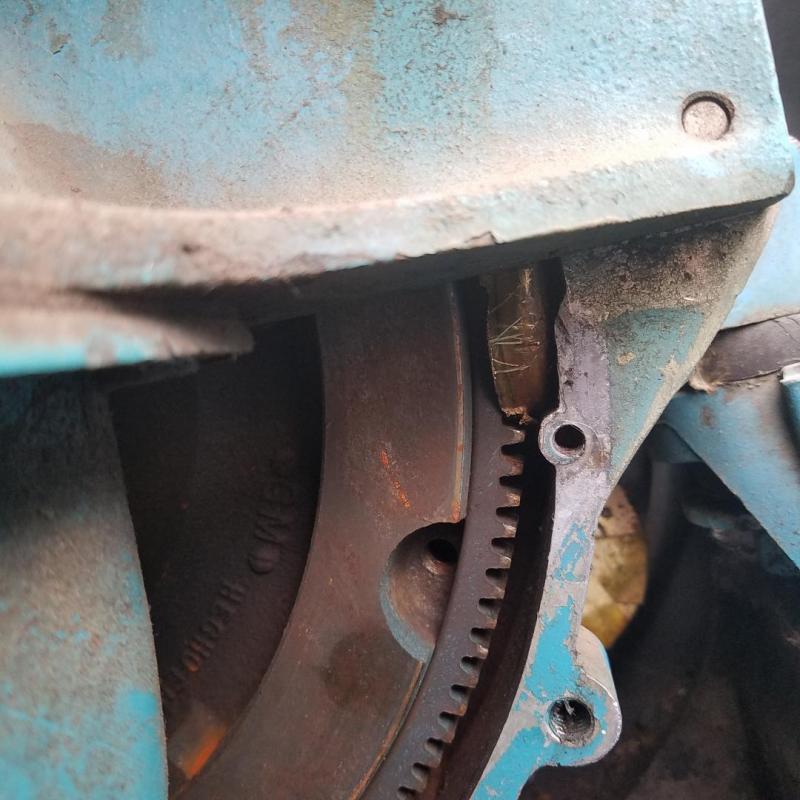

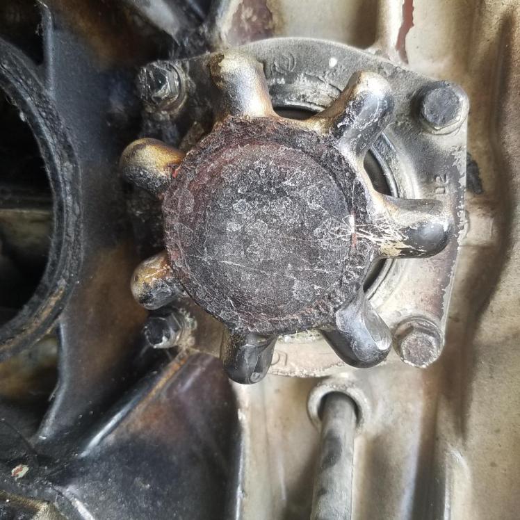

what i do know: I'm not pumping water, and I've got a frost plug out of the back of my motor.
What i don't know: if the impeller is behind the ball gear in the outdrive or the intermediate (I've been able to find a video of replacement but not sure exactly which bit I'm looking at) I'm trying to pull apart as little as possible so I don't get things too fouled up.
also I'm not sure what my best approach is to get to that plug. please educate.

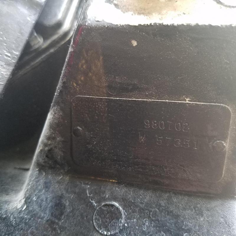

I'm including some pictures that may or may not prove helpful. I'm not even sure what sort of drive I have but I know the boat is a 1975 for what it's worth.

i saw that parts list elsewhere on this site but was unsure if that was actually my drive.

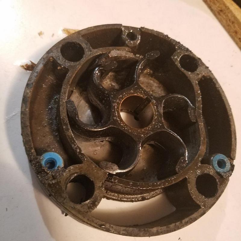

with the help from this forum and some patience i got to the root of the problem. a busted impeller housing.
I'm not sure what would cause this kind of damage but I'm guessing poor (or nonexistent) winterization which I know is the cause of my other problem up in the motor.
now to scour the interwebs for a new impeller housing and start a motor pull while that ships.
