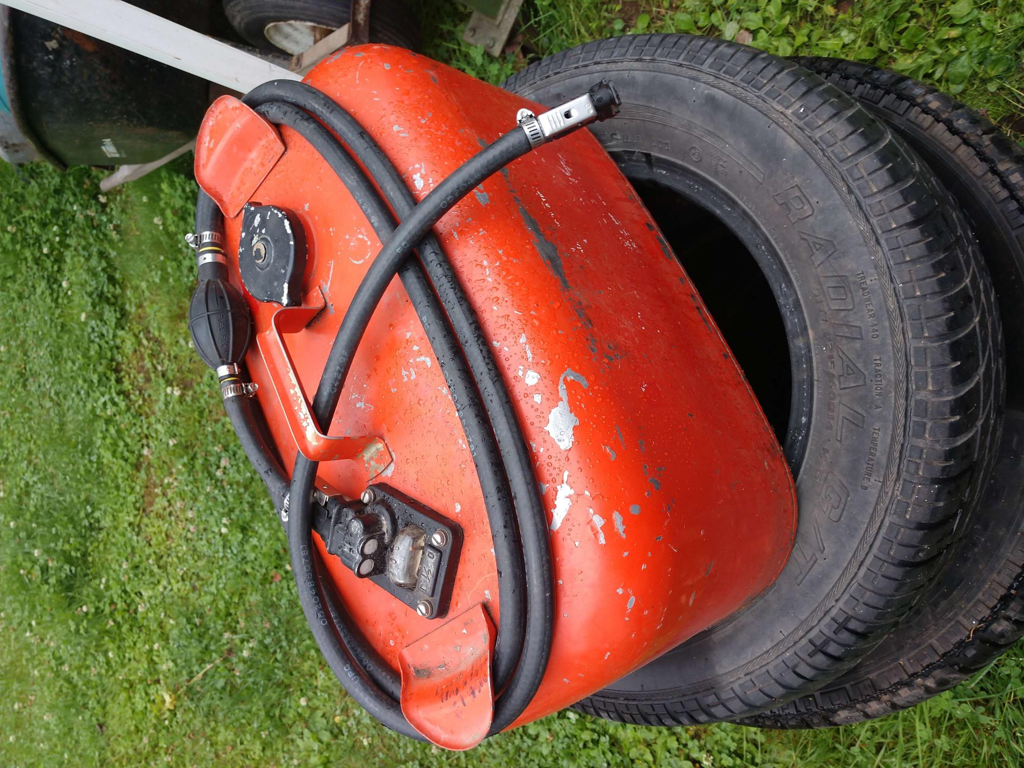

Is that a factory Evinrude tank? I would suggest finding a REAL fuel tank....like a steel OMC with real stainless steel pins. What you have is a problem just waiting to happen, my friend. If it has a grey laminated plastic hose, then give that to your worst enemy too. You need one of these. Rubber hose, Gates. This tank, hose, primer bulb is 35 years old.
Sorry this Android and Marine Engine don't agree on photo orientation.
