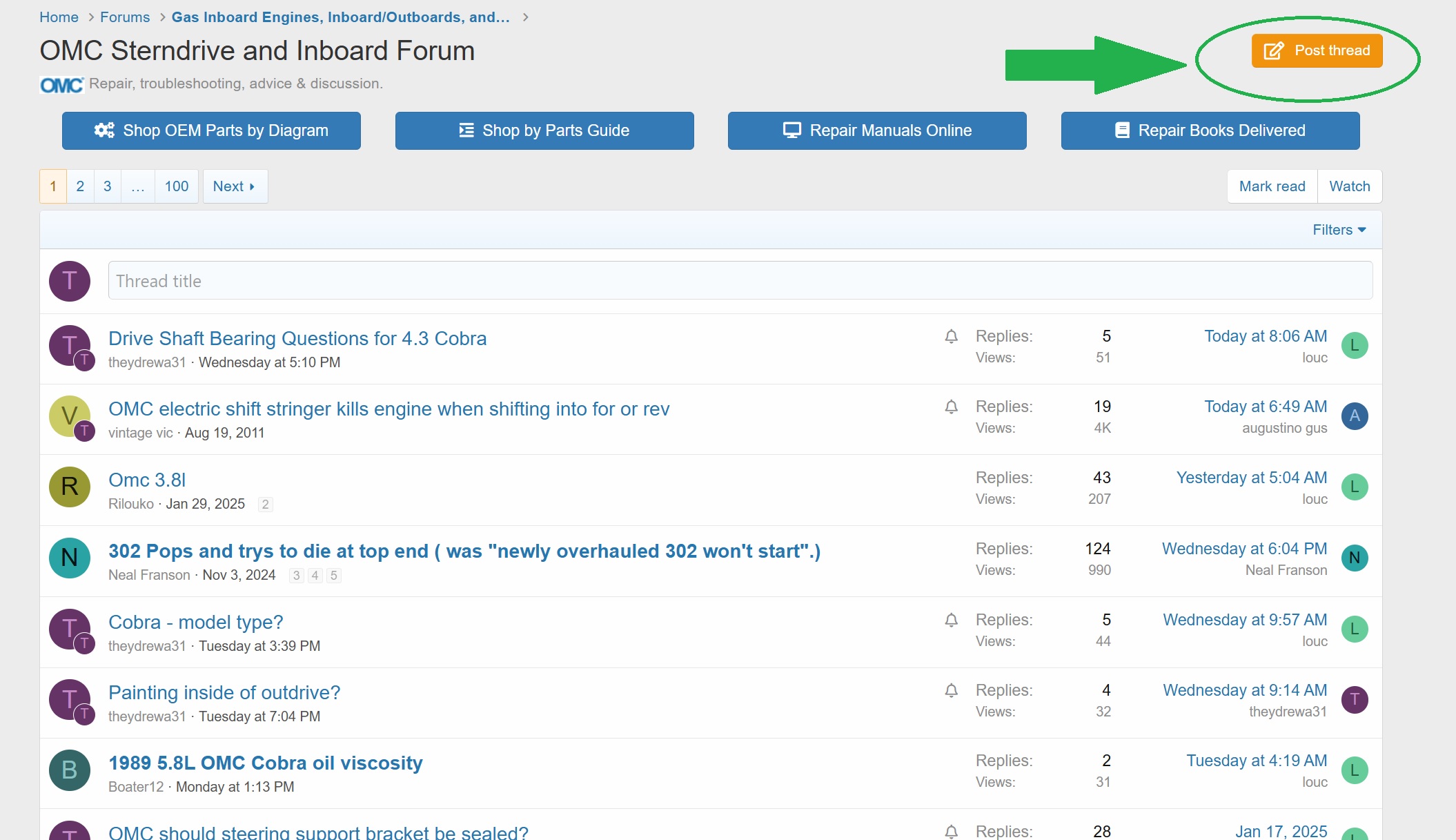

Including a photo to show you where the button to post a new thread is just to make it easier on you. The button is circled in green with an arrow pointing to it in the photo below. Click forums, then OMC from the I/O section, this is the page you will get to.
