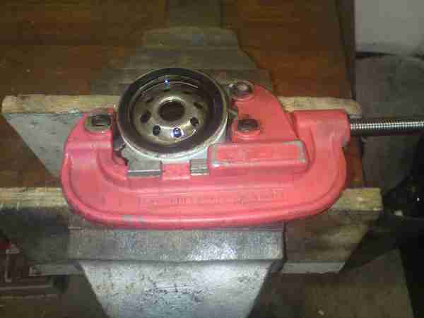

Got it cut open tonight.
Should it be spotless?
It has some grit in it but not much.

Some more pictures as it dried out a lillte.

there's enough bearing material in that second pic especially to say there's engine damage. However, it's not as bad as one would suspect if a bearing had spun.

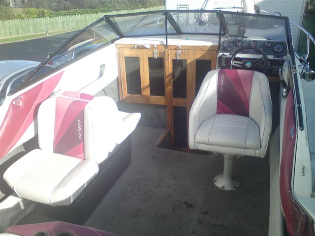

Thought I may as well take the time to restore the inside so gutted it today and found the floor is rotting out of her.
This is going to be an expensive summer.
