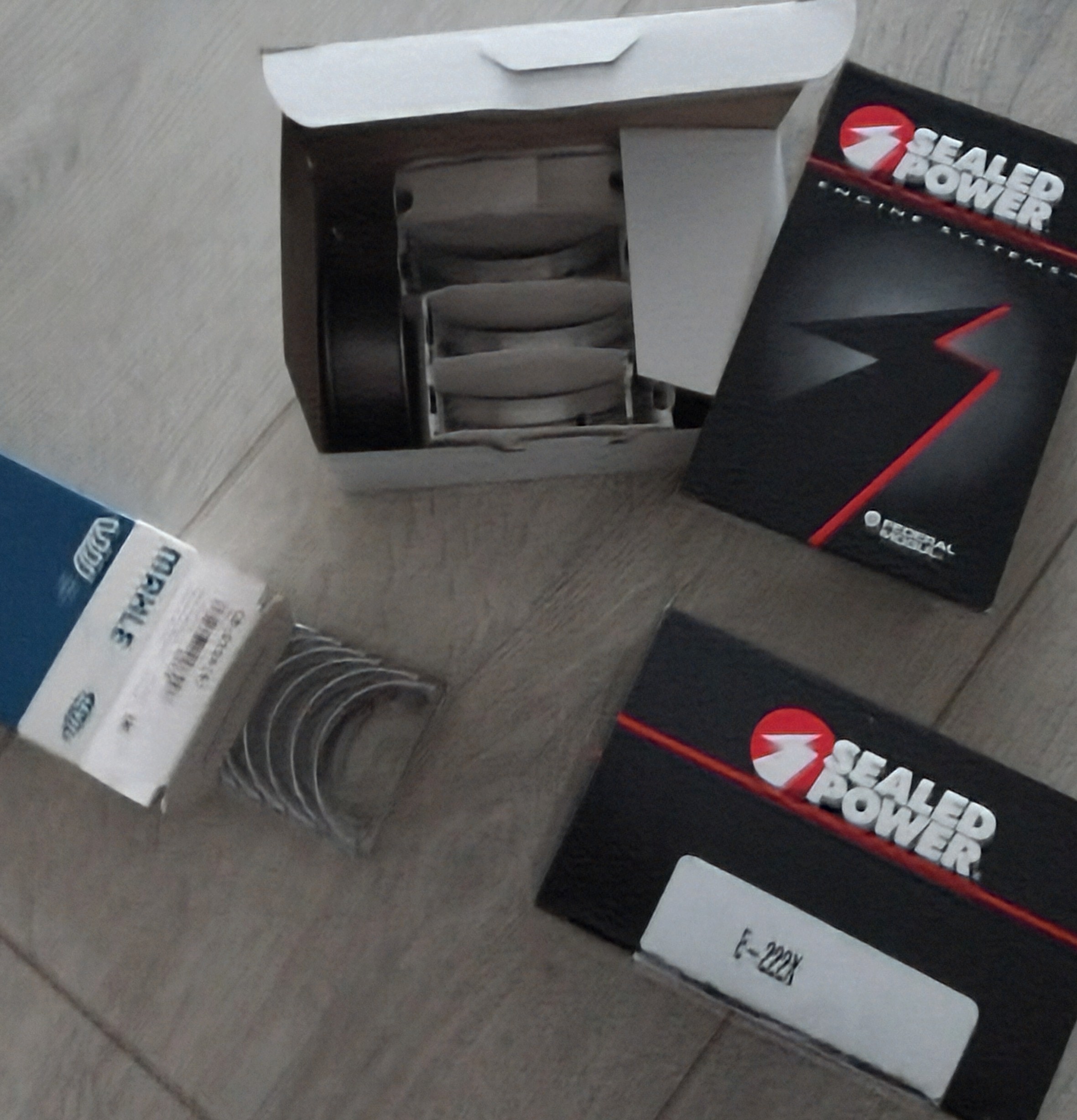

Today i received my first order: crankshaft bearing, rod bearing and piston ring 👌
Obviously the bearings are identical 😁👌

Crankshaft bearing, rod bearing and pistons rings Reception

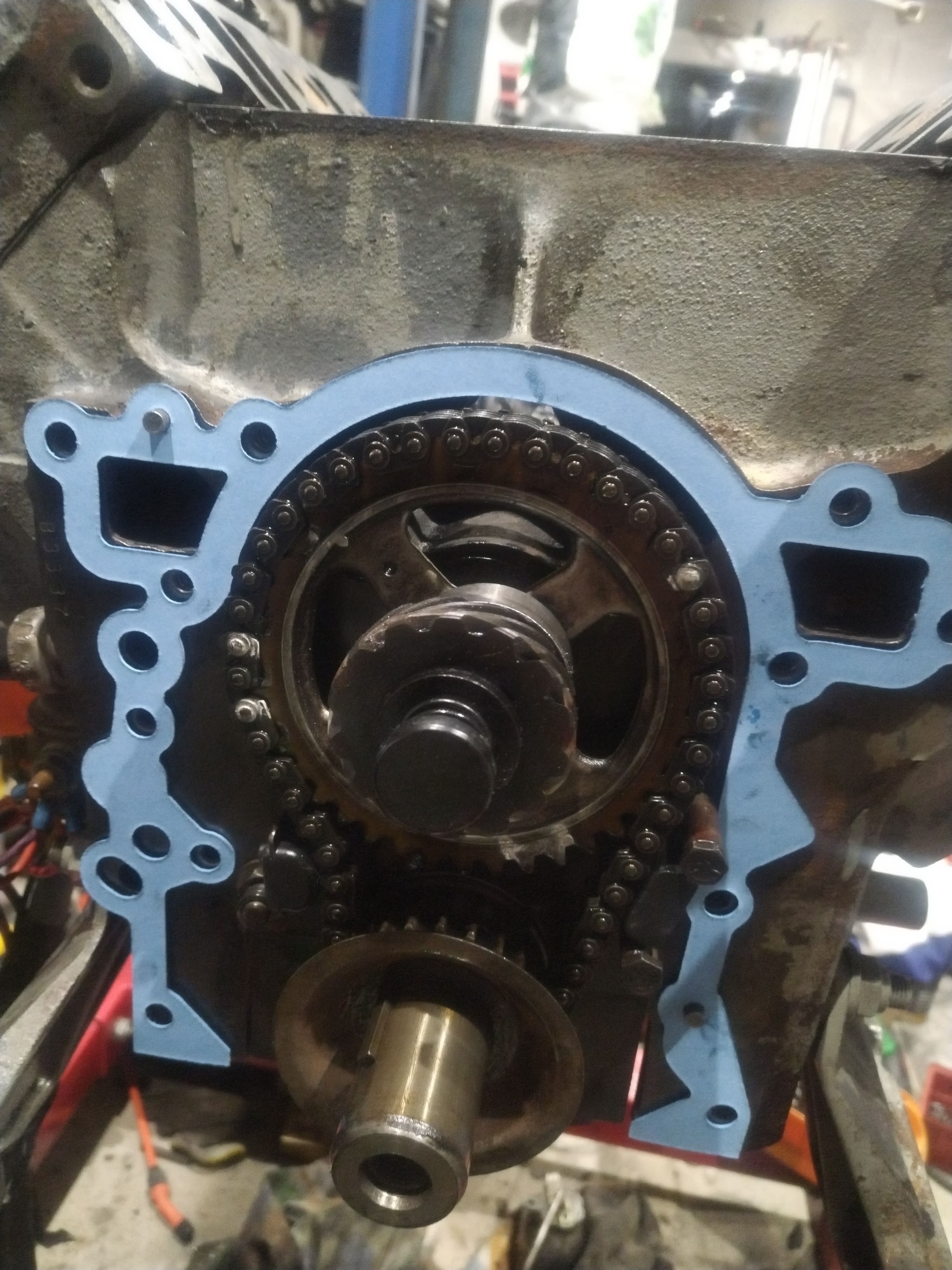

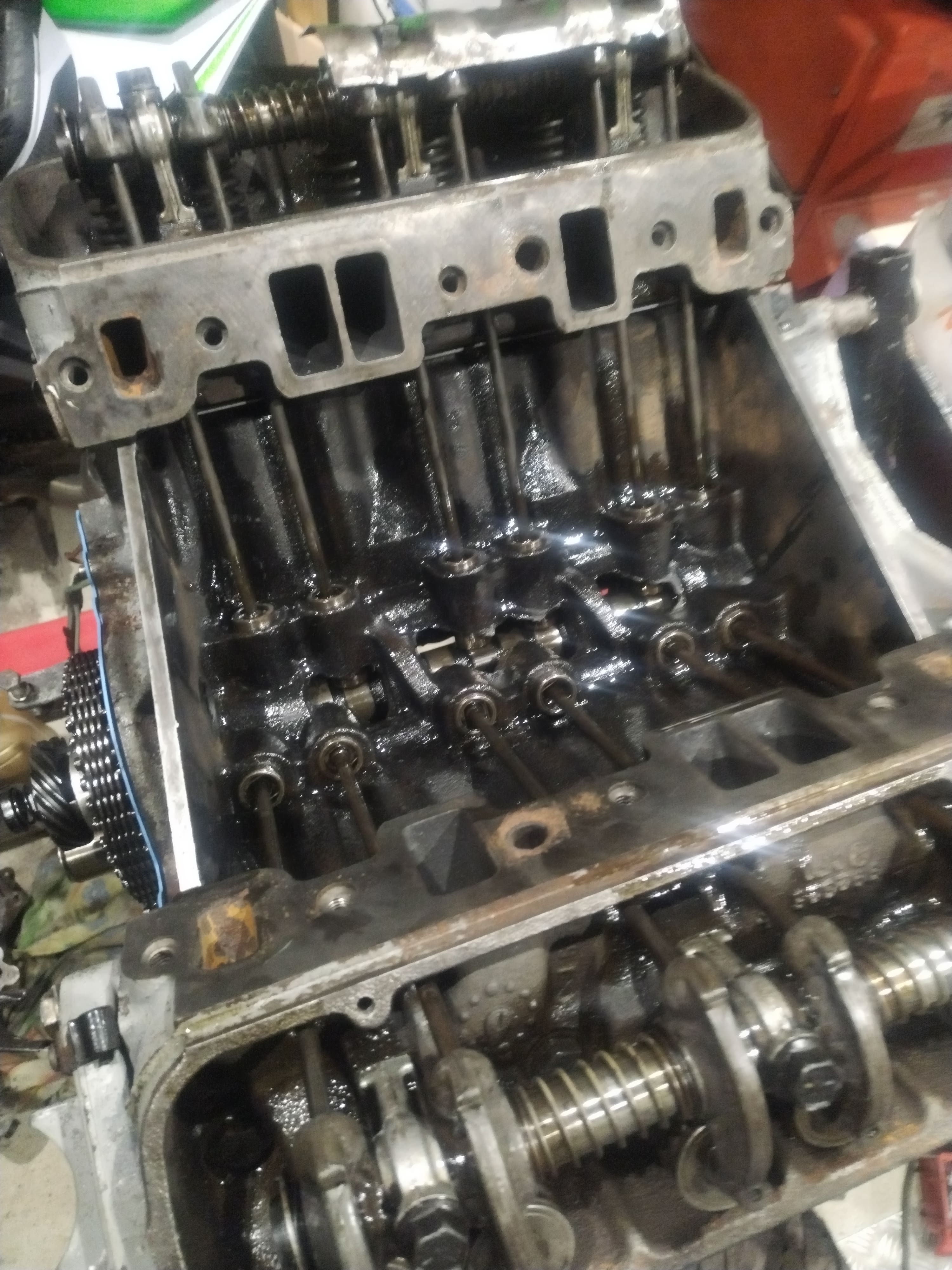

remontage des culasses et de tous les éléments
Distribution (nouveaux tendeurs) avec pose du nouveau joint prêt à être refixé

The top of the engine is easy and very quick to reassemble
I turned two rounds to check that I didn't shift the distribution, that's the basis
