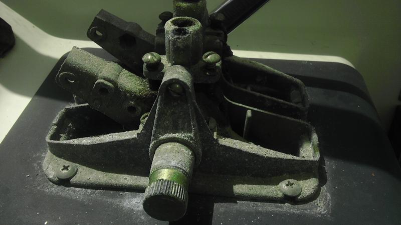

Just returned from the Bahamas on my new to me 1989 Tiara 3100 which has twin Crusader 454's
Got really tiresome having to hold the throttle controls for four plus hours to prevent "throttle creep"
I've looked for a tension adjustment screw, but can't find any.

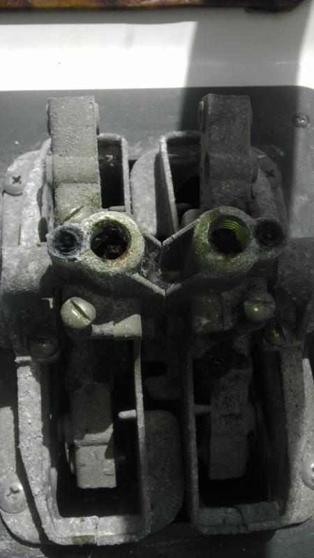

Morse SR Twin, same as my 4. The friction brake is the strap held on with a couple of slotted screws, which is visible in your photo. Try to tighten the 2 screws on each. Don't confuse with the "tower" mounted clutch detent, which is not installed on the unit in your photo.

I've tried to tighten them but they seem to be at the end of their range. Is there a bushing or something that goes under the strap?

I can only guess that maybe there is some unwanted grease under the friction strap. Try to remove, clean up , and assemble dry. I've done many a trip to McLeans Town. Once by moped. But the real treat is two islands SE of that. That's the pix in my profile. It's been two years since my last islands trip. Jones'n real bad!
Thanks, I'll try that before the "clamp on the cable trick"
