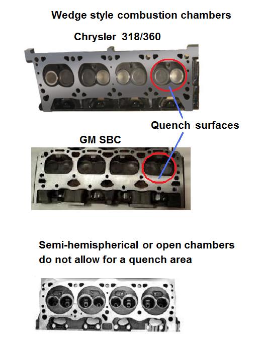

If you go with the SBC 5.7L, have a good quench effect built into the cylinder head combustion chamber area.
The Wedge style combustion chambers offer a quench surface that is seldom taken advantage of. Don't settle for the typical GM style full dished pistons that GM provides and that most re-builders provide. :mad: :mad:
You'll do much better with a piston profile that mirrors the quench surface of the cylinder head.
A good quench dimension for the Marine engine is in the neighborhood of .038" to .040".
Any good piston supplier can provide the correct profile for you... and most any good machine shop will know just what/how to do this.
The Q/E will not only offer more torque, with the Q/E also comes a more efficient engine in terms of less fuel burn.
This is Fact..... not Speculation.
I'm not as familiar with the Chrysler 318/360 engines...... but I'm thinking that if you stay with the Chrysler 318/360s, that these also offer a wedge style combustion chamber, of which means that a good Q/E can also be built into the Chrsyler Marine engine.
BTW, if you get that Deer-in-the-headlights-look when you mention "Quench Effect", find another machine shop!
Rick- Thanks for the education. I looked into a bit, and see the point of building mechanical octane into the engine with the correct pistons. Seems like flat tops, or something similar is the way to go. Very, very interesting. I will follow up with your suggestion. Thank you so much!! Phil
Phil, you'd need to know the cylinder head's combustion chamber volume (plus bore/stroke) before deciding on a piston profile.
Flat tops may work...... or you may need dished piston....... but the key is the deck area of the piston in that it "mirror" the cylinder head's quench surface best it can.
For the SBC, this could be a D-dish, Reverse Dome or a LCQ piston....... and for the 5.7L with 76cc chambers, the flat tops work out to be ok.

Phil, at the risk of being the Quench NAZI here........ I'll offer this to you.
As mentioned, this engine also uses a wedge shaped combustion chamber, and is capable of a quench design.
Torque is what we want... and is all about LPCP.
LPCP = location of peak cylinder pressure.
Most engineers will agree that LPCP should be near 12 to 14 degrees ATDC. Gas or Diesel... Hot Rod, lawn mower, tractor, go cart, car, truck or even an airplane piston type engine....., it makes no difference.
Thisis when the combusted gasses are at their most expanded value, and have their greatest leverage advantage over the crankshaft throw. This is what makes torque.
