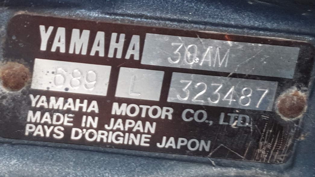

A 2 or 3 cylinder motor ?----Model # / picture required.
As I said it's a two cylinder "Yamaha 30AM". There is little more info on the plaque but i'll attach a pic
