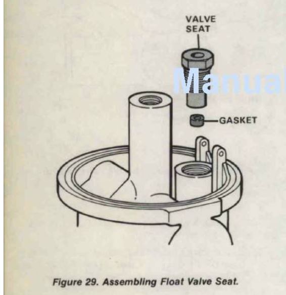

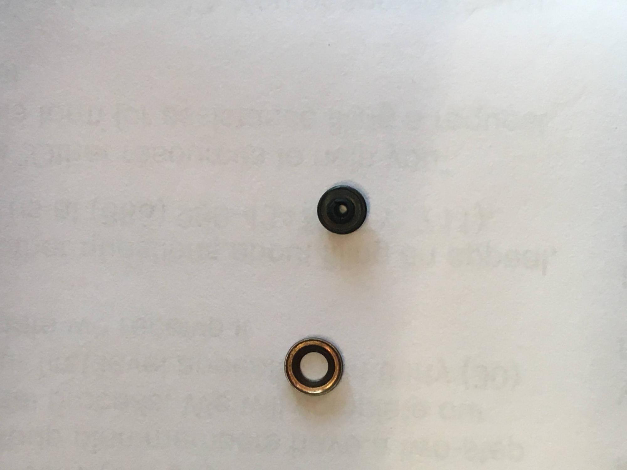

Ok. So I took off the bowl to inspect valve seat, bowl, needle, etc.. When I unscrewed the valve seat I noticed 2 things down inside the hole: 1. A tiny brass washer and 2. A black rubber stopper with a pin size hole in it (I assume to let fuel pass). The black stopper was on the bottom and the brass ring rested on top of it. Please check out the pictures. So I looked at the manuel and it was waaay confusing!!! It called for a washer but the picture of it was not very descriptive. What should I do, put both of them back or just one. If just one, which one. I did rebuild this and maybe I wasn't supposed to have both of them in there. I'll incude a picture of the manuel also.
Thanks Tim

Does the seal fit inside the washer? The washer(from the pic) looks like it has a lip that can hold the seal.
Add a pic of a side view of the washer/seal.

3. The seal does not fit securely into the washer. The washer just sits nicely on top of the seal and does not block the pin hole in the seal. The washer does have a small lip but I can not tell if it was originally there or it just formed after use. Just want to replace it anyway.
