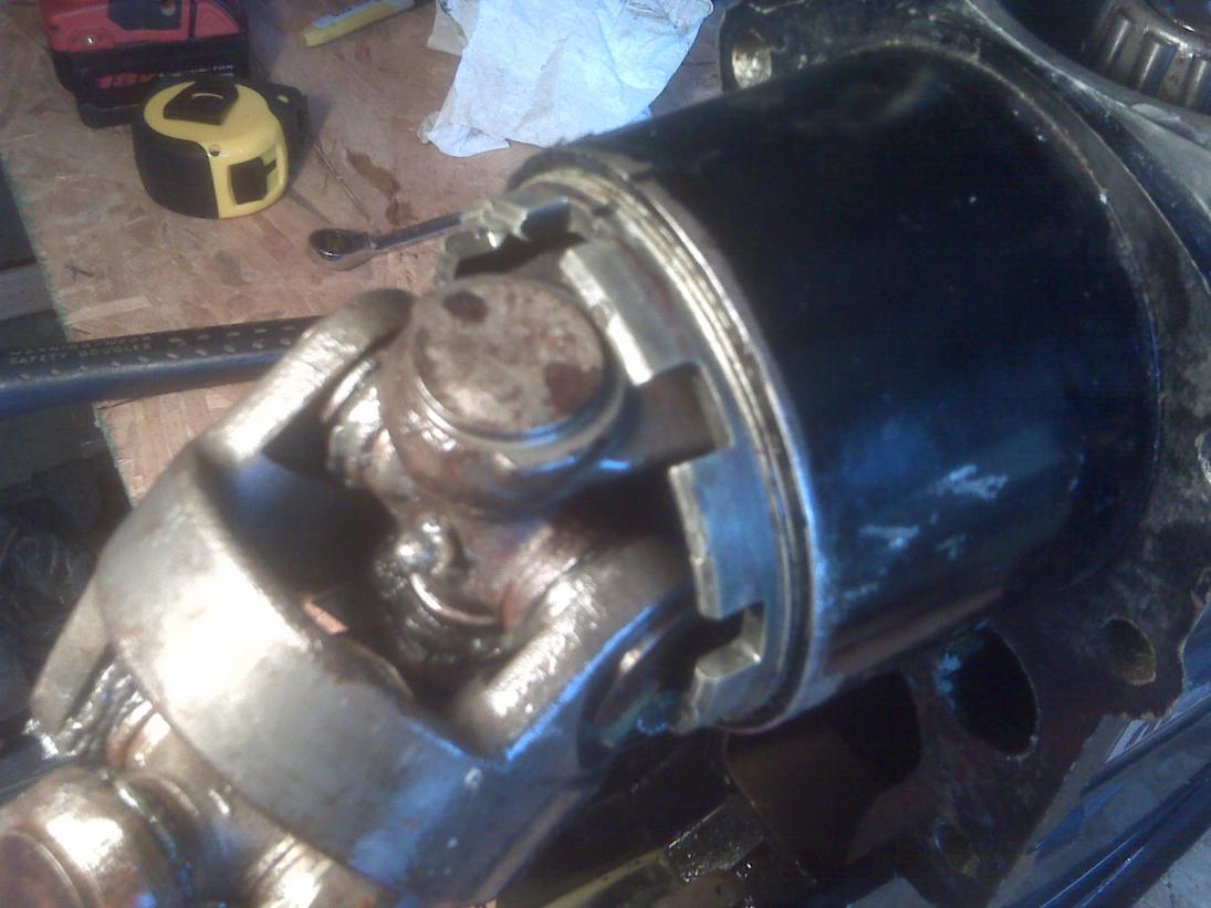

I've got a #1 drive with a 165 inline 6. I've pulled the outdrive off the boat and I've got the lower and upper seperated. I'm resealing both units. I've got a watery oil mix in the u-joint bellows which means the oil seal right behind the u-joint is blown right? So I've gotta get the u-joint roller bearing retainer off. I don't have access to the special wrench. Do you guys know of any other way to get that big a#% nut off?

Also I think I know why I've got a ton of water in the outdrive after only running it for an hour. There was no oil seal right above the impeller. I don't know where it went but its just gone. I didn't even realize one went there until I really looked at the exploded view in the manual. I think I'm a better mechanic than the yahoos I used to take my boat to for service. Another reason I'm doing this myself.

Really need the wrench to torque it back properly. I doubt it`s what you call a seal. It`s called a slinger washer.Most water intrusions are from bad bellows , shift shaft seal, water pump base seals, upper drive shaft seals, cracked case, missing quad seal.
The seal he is refering to is commonly called the upper carrier seal. If this is bad and the gear oil was allready contaminated then it would allow the milky gear oil to get into the bellows.
Considering it is a 1 or I drive it is possible for several seals to be bad...............30 + year old drive with unknown history..........
The only way to be sure is to pressure check the drive.
Special tool is required for disassembly but mostly for reassembly to achieve propper torque.
In my Seloc manual they are showing an oil seal right behind the retainer nut in the exploded view. In order for oily water to get into the u-joint bellows that has to be blown right? If it's the bellows that's leaking it would just be water and no oil.
goes both ways, most times the seal grooves the input yoke or there was water in the boot at some point to start creating some rust and the rust particules damaged the seal.Assemble the unit and use a hand pump, bicycle pump, etc and a gauge hooked into the top vent plug

page 3A-7 ,this link. You need 200 ft/lbs to tighten it properly.
http://www.boatfix.com/merc/Servmanl/6/6A3R3.PDF
The spec is 200 ft lbs but be very carefull with that..........!!!!
If you read one of the other pages it shows what the actuall torque setting on a torque wrench should be based on the length of the torque wrench used.............
If one was to torque that nut to 200 it would not be a good thing.............just saying.....
The diagram shows what the special tool looks like and it also shows why it is needed due to the torque spec including it into the calculation..........My torque wrench is 20 inches long so my torque setting is 125 ft lbs as an example..........

Well, I got that big retainer nut off without buying that $60 wrench. I just used a big C clamp with a 4' piece of pipe on the handle. That thing came right off. Got all the oil seals changed and put everything on the upper unit back together.
