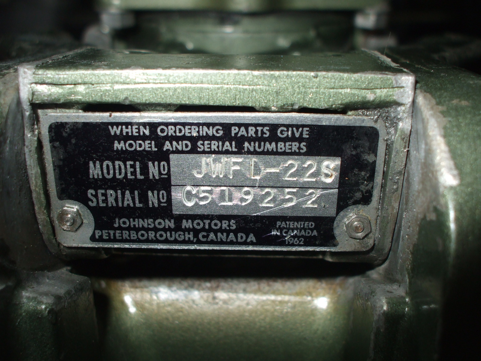

HI Guys, Newbie with a problem here...I buy restore and collect 3 hp Evinrude/Johnsons and I have a problem. I have one which is almost restored with virtually everything new but it runs, or seems to run very rich and oily. It starts without choke and only runs at low revs with lots of smoke and an oily residue below the water/exhaust ports on and down the lower leg. The only time it runs sweetly is when I turn off the fuel tap to run her out of fuel and then it's for a few seconds till she stops.
