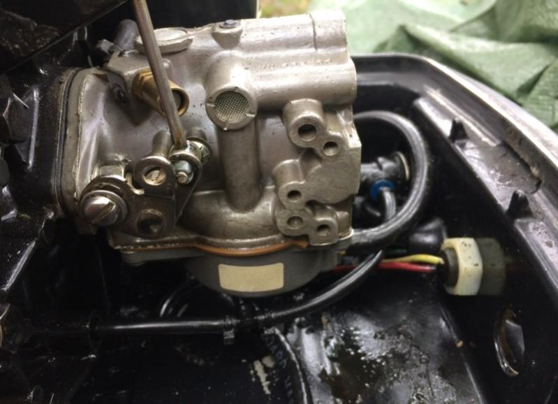

Racerone:Is that wee hose part of the manual primer system? I can see a fuel line coming out of the manual primer and going to a "T"; after the "T" one line goes to the primer nipple on the top starboard side of the carburetor and the other line goes to the cylinder block. I hope the attached picture shows some of this detail.

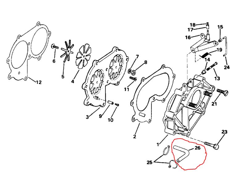

Is the item #26, circled in red below, an oil recirculation line? It's not listed in the parts description as such, in fact, it's not listed at all.

I don't recall ever seeing such a line on my 1996 25hp Johnson but I'll definitely look for it the next time I'm at the boat.
You like many others are grasping for straws.---Have a high level of doubt.-----You need to look on the cylinder block page of the parts manuals and the hose is shown there .----Absolutely no doubt about it !!-----It is shown on 1976 model to 2005 models of that engine block.

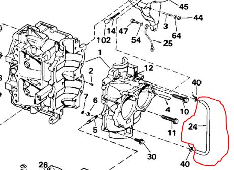

I've gone and looked at the Crankcase and Cylinder parts diagrams and may have found the elusive oil recirculation line. I've circled it in the picture. There's no reference to it in the parts list and no parts number.
Are you still denying the fact that hose does exist on your motor ?----The hose in the circle of red is on your motor !!----Most dealers have that on a 50' roll.
Sorry racerone. My boat and motor is 100KM away from me right now and I can't physically inspect the motor. I will the next time I go to the lake. In the meantime, I believe that it exists, you and timguy, are very convincing on that. I was just looking at parts diagrams to find it.
