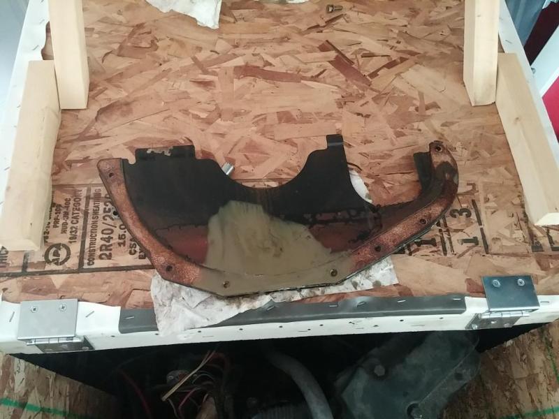

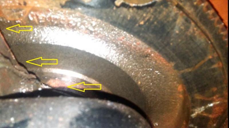

I removed the dust cover from the flywheel. This is what the "flywheel facing side" looked like. Judging from the pattern or location of the oil does this indicate where it might be coming from?
