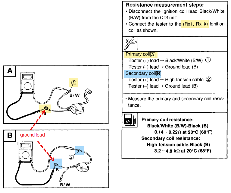

Not your specific coil but this might give you an idea.
