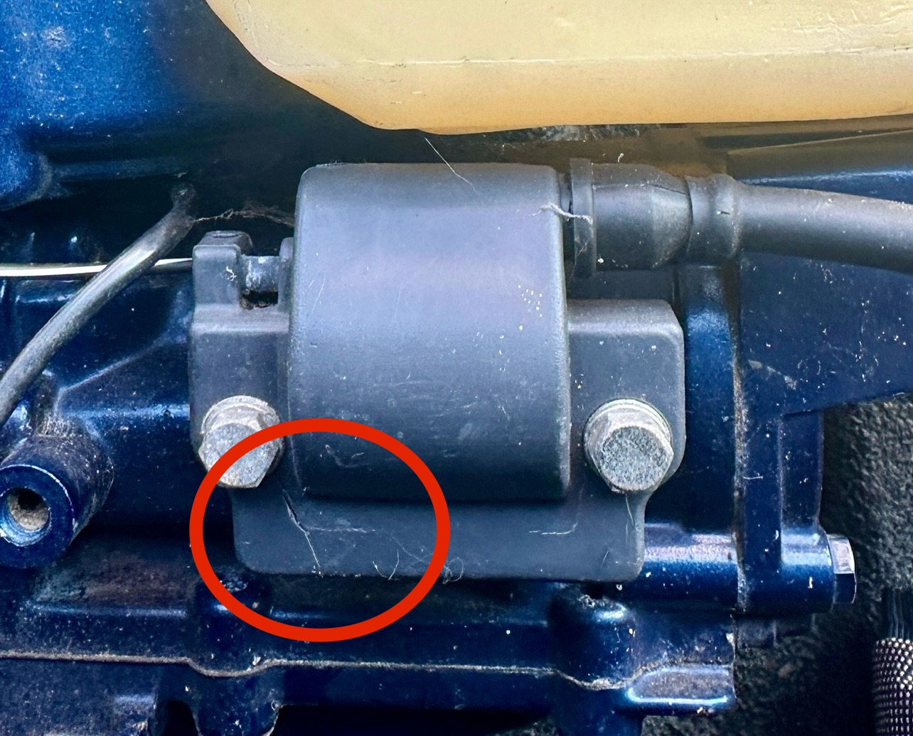

I was given an older Nissan NS3.5A motor. I was told it only needs the ignition coil to run. There’s some hairline cracks and supposedly it let moisture in, see pic. They seem to be long since obsolete. My question is there another option. Can it be fixed, maybe fit another coil and fabricate an adapter to mount it. Any help would be greatly appreciated.

Thanks for the help. That’s the one for the NS3.5A2, which I was told wouldn’t work due to the 2 wires going in. I should have taken a better pic of mine. I’ll add a pic showing the 1 wire vs 2. Maybe it’s the same and I can cut the 2 wires cap one and splice the proper fitting on the other, but I don’t think I’d be that lucky.
