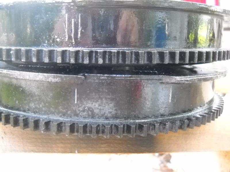

Check for TDC top dead center?Top flywheel middle mark,top piston should be all the way out.Or close.This can be sheared flywheel key ?Ignore bottom wheel.
Then into the fuel system.'
