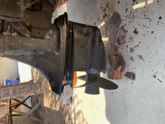

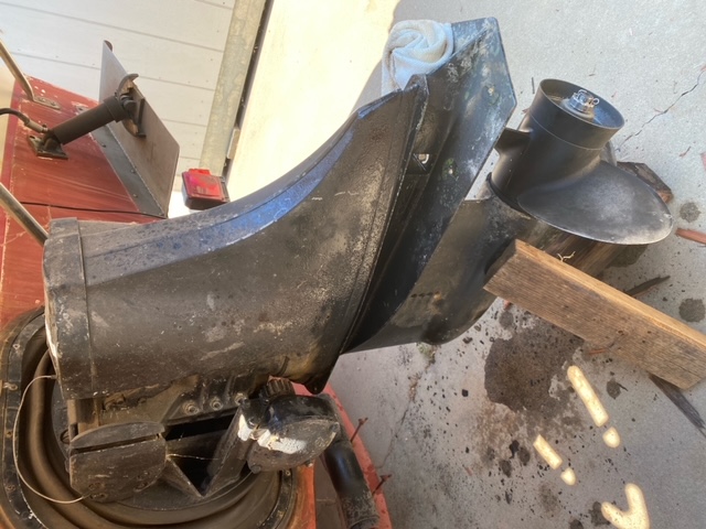

Hi how do you get the lower end off and get to the impeller? I see you got no replies. I posted and got no help wth? This is my drive.

TO SR230 disconnect the shift cable ,remove the bolts from the top cover of the drive , carefully lower bottom half while guiding the shift cable out of the upper housing.
BE VERY CAREFUL WITH THE SHIFT CABLE
