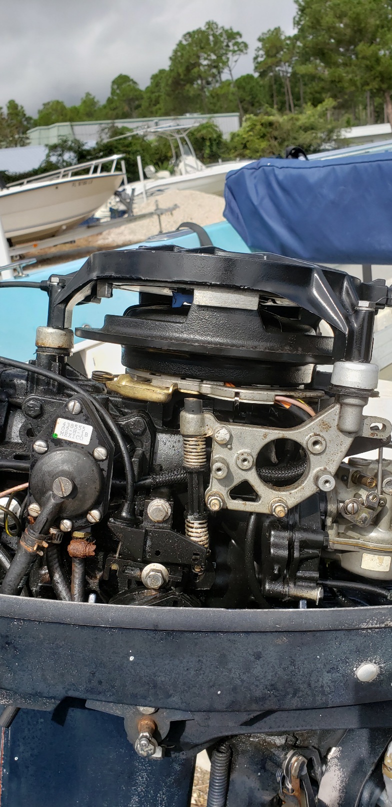

The powerpack was under the flywheel when it left the factory.----UFI it was called.----I do not know what state / condition your motor is in today.----You can test the charge coil on that motor.----Pictures of your motor help.

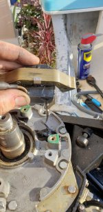

So I swapped out the power pack...it started right up, idled great, as soon as I have it gas it died, starts again, throttle like it...pulled the flywheel back off and found this... something leaking out if the back of stator coil...pretty sure its shot...20201010_172728.jpg
