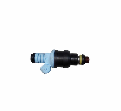

Can I have an injector that is failed open? I am not a mechanic, is it a complex process to get to and remove injectors?
