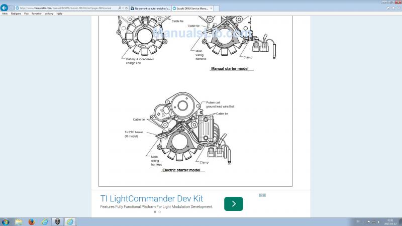

Found that image of some of the wiring.. Second image shows wiring to "PTC"-heater which is the autochoke I guess, uses resistance heat to loosen spring that Closes choke.
Can you tell what other wires comes out of rectifier? Named Y-Y, R-R, W-W???
