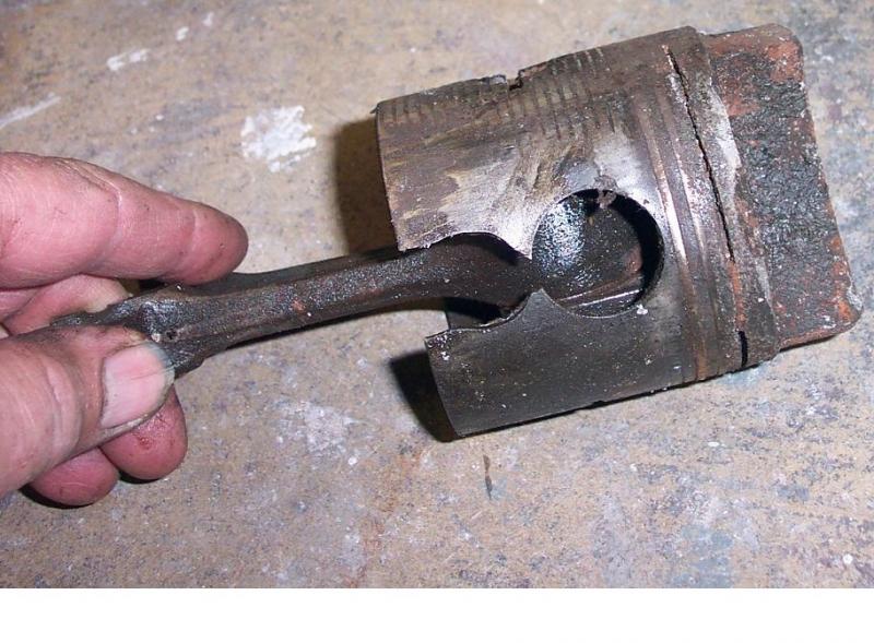

Right. Hopefully the block is salvageable. I run these motors and have saved at least 5 of them with burnt top pistons. Here's what one of the LEAST damaged pistons looked like.
